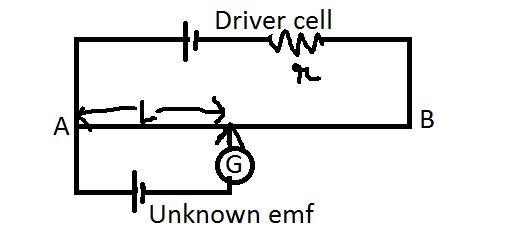

if a potentiometer has driver cell and wire AB ,then an unknown emf (emf<driver cell) is balanced at some length L. does the balance point change if internal resistance of driver cell is changed?
V= kl K= potential gradient
if we increase the internal resistance ,the potential drop across wire AB should decrease and so balance point must shift.. But the solution says it will not change.
You are right, the balance point will shift if you change the internal resistance of the driver cell. It will not depend on the internal resistance of the unknown cell
But in solution( i have checked in 4 books) says it will not change since we have set constant potential gradient across the wire.. and i don't even understand it
It is wrong. The potential gradient across the wire is E/(ri+Rwire), where ri is the internal resistance of the driving source. Book solutions are wrong quite often. They certainly thought of the internal resistance of the measured cell.

Disconnect the unknown emf for a minute. Then the voltage across L is variable by varying the driver cell resistance, obviously. So adjust the driver cell to equal the unknown emf. When you reconnect the unknown emf there will be zero G current since the two voltages are the same. Disconnect the unknown emf again and readjust the driver cell resistance, then reconnect the unknown emf. Is the G current still zero?
Think of connecting two batteries of exactly equal voltage, + to +, - to -. No current, right? But take two batteries of dissimilar voltages and what happens?
