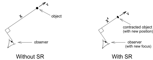

First, let me clarify if my understanding of length contraction is correct. Is it accurate to say that relativistic velocities not only affect the measured length of an object in the direction of motion, but also the distance to the object from an observer in the direction of motion? For example, if a 1m wide object (at rest) is 100m away from an observer and traveling away at 0.87c (γ = 2.0), length contraction states that the observer will measure the object as being 0.5m wide. But, does the observer also measure the object to be 50m away, due to the fact that the measured distance gets length contracted?
If so, the following diagram is correct, no?

No. Only if the endpoints are moving is the distance between them length-contracted.
Here are three cases to consider:
1) The length of a spaceship is defined as the distance between its nose and tail. If the spaceship is moving relative to some observer (or the observer is moving relative to the spaceship - it's the same thing), then that observer will find the spaceship to be length-contracted. An observer on board the spaceship and therefore at rest relative to the ends does not find any length contraction.
2) The spaceship is flying from Earth to a star that is at rest relative to the Earth and many light-years (as measured by an observer on earth) away. The earth-bound observer doesn't see any length contraction (of course!).
3) From the point of view of the observer in the ship, he is at rest while the Earth and the distance star are in motion (the Earth behind him and moving away, the star in front and approaching). He finds the distance from Earth to star to be length-contracted.
#2 and #3 are the same situation as if we had a very long ruler stretching all the way from Earth to the star. The ruler is at rest relative to the Earth but moving relative to the ship, so is not length contracted according to the earth-bound observer but is length-contracted according to the spaceship observer.

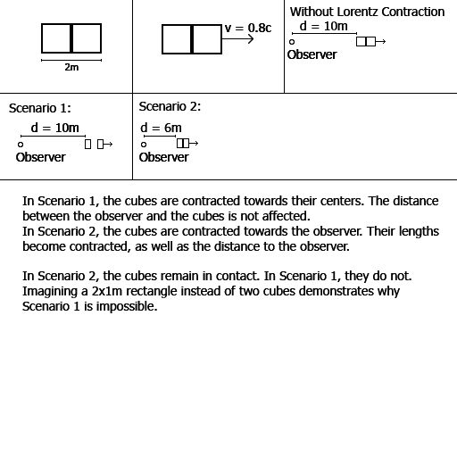

Yes, I agree with all of your points. But I don't believe they contradict what I'm asking. If only the length of the object becomes contracted, and not the distance to the object, then around what point in space does the object contract? For example, if you contracted an object around its geometric center, the length of the object would become contracted but its distance from the observer would not. On the other hand, if you contracted an object around the nearest point to the observer, the length of the object and the distance to the object would become contracted. For the former, imagine two 1m^3 cubes in contact along one face. If the cubes are traveling away from an observer at 0.8c in the x-direction, their lengths become contracted along the x-axis by a factor of 0.6. If we imagine that only their lengths become contracted and not their positions, the resulting 0.6m x 1m x 1m cubes will no longer be in contact with each other. On the other hand, if both their lengths and their positions become contracted, they will appear shorter as well as closer, and they will still be in contact. See the following image:
Length contraction is not about an object physically contracting. In its own rest frame, the object will appear just as usual with its normal rest length. In relation to the observer which it is moving relative to, the object is already in motion and therefore length contracted. The only question you could ask is "how did it become like that when it speeded up?" but this is then a question of how the object was accelerated which is not really a necessary condition to discuss length contraction on its own, which is just about how an object appears in a frame different from its rest frame.
Okay, is this diagram false, then?

Suppose we have spaceship that is 100 meters long as measured by an observer who is at rest relative to the spaceship. and is moving from left to right at .6c relative to you and me (I chose these numbers to make the arithmetic easy). Because of length contraction, the spaceship is 80 meters long according tou measurements - any given time the position of the nose of the ship will be 80 meters from the position of the tail at that time.
Suppose at time zero the nose of the ship is even with you and me. The tail is 80 meters to our left. One second later, the nose of the ship will be .6 light-seconds (a light-second is the distance that light travels in one second, and the ship is moving at .6c) away to our right, and the tail will be .6 light-seconds minus 80 meters to our right. All other points along the ship's length will behave similarly - they were somewhere between zero and 80 meters to our left at time zero, and wherever they were, they've moved .6 light-seconds to the right one second later. Thus, the velocity of all points on the ship is the same, .6c, and is unaffected by length contraction.
The problem does become much more complicated interesting if you imagine the ship starting at rest relative to us and accelerating to .6c. In this case, its measured length will start at 100 meters and contract down to 80 meters as it gains speeds and then settles down at .6c. We will find that different points along the ship accelerate at different rates and that while the ship is accelerating the speed of the nose is not equal to the speed of the tail. Thus, the calculation of the position of the nose and tail and the distance between them becomes much harder than after the ship is at constant speed. However, even in this case, the distance to the position of the nose, the tail, and anywhere in between will be unaffected by length contraction - just as in classical physics, we'll calculate the position of any point on ship at time ##T## as ##s=\int^T_0 v(t)dt## where ##v(t)## is the velocity of the point in question as a function of time.
To really understand the relationship between length contraction, measured distances, and acceleration, you'll want to google for "Bell's spaceship paradox" and "Born rigid motion". Be warned that the spaceship paradox in particular has tripped up even some respected experts.
Suppose you had a train moving along the track at a relativistic speed. You fly by in your space ship, moving in a direction parallel to the track. You will measure both the train and the track contracted (the train more so). If instead you were standing beside the track, even if very far from the train, you would measure the train contracted, but not the track. In both cases you would determine the amount of contraction based on the speed you measure relative to you.
@taylorules Distances and time intervals in a frame of refernce are measured by rulers and clocks that are at rest in that frame, and thus not contracted or dilated. The velocity of objects in that frame is defined based on those resting rulers and clocks, so it`s also not affected in the way you suggest.
