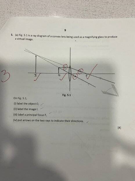

The kid wrote that the direction of the light should be coming to the eye from the image. But the teacher marked it wrong and said that the light would come from the eye to the image
You can see from the picture that the teacher has circled the arrows which shows light coming from image to the eye, and drew it in the opposite direction saying the light goes from the eye to the image.
The marking scheme of this paper only says the correct direction does not specify which is the correct direction. But on YouTube there is a video of a person doing this question and he draws the arrows this way
here is the link to the video with the timecode
but I have not found any other sources on the web showing that light travels from eyes to the image. And it makes no sense to me.
so I turn to you guys.
please give me a definitive answer
thank you for reading in this long message

When I was in school, check marks indicated correct. Note the 3 which to me indicates correct points earned.
Likes nasu, vanhees71 and russ_watters
Emphasis added. That is good, because it should make no sense to you or anyone else.
Likes vanhees71 and dlgoff
The light is in fact coming from the Object to the eye. The (virtual) image appears along that line.
You are correct.
I suspect the person in the video thinks that light travels from object to image, which is true in the case of a real image such as a slide projector. The case in the question, however, is a virtual image and no light goes to the image at all and this mnemonic fails.
In any imaging system light must always go from the object to the eye (maybe bouncing off a screen or something). It can't go the other way. People's eyes do not glow.

I'll be more precise. Vision does not in any way depend on light coming from the eye that is doing the perceiving (the sole exception to that is when you look at a reflection of your own eye). Light always comes from the object to the eye or camera doing the viewing. So the video demo of the mark scheme is unequivocally wrong. I hope we can agree on that.
Eyes can be objects in such a system, but that is not the case here. Or at least it is not shown as such, and even if the object were to turn out to be an eye the video is wrong.

Thank you all for your contributions
I guess I can say that we have reached a consensus that light does not come from the eyes. And that when we draw ray diagrams, the light from an object goes to the image only in real images and not in virtual images. Thank you very much.
