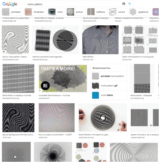

As @Jonathan Scott says, you are seeing Moire patterns, not anything to do with the polarization of light.

BTW, a Google Images search turns up lots of examples of Moire patterns:

Just to be clear it is an interference pattern between the "wavelength" of the screens not of the light.
And just to muddy the water: a vernier scale actually uses a (usually 1D) Moire pattern.
Likes sophiecentaur, berkeman and Keith_McClary
