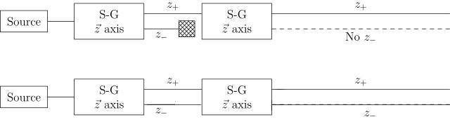

Suppose one scientist performs a series of experiments, and another scientist does the same thing. But unbeknown to either of them, a highly evolved alien measures all of the particles the first scientist is going to test, just before he does his measurements.
Question: Would the two scientists find different results from their experiments?
It depends on the nature of the measurement that the alien performs.
In the formalism, everything that happens before a particular measurement is considered part of the preparation procedure, and the theory predicts the statistical distribution of the results of measurements made on a system after a particular preparation procedure. Thus, the alien's measurement (and any other measurement or interaction) is part of the preparation procedure for the first scientist's measurements.
Two examples:
1) Particles pass through a vertically oriented Stern-Gerlach device, we discard all the spin-down ones, our scientists measure the spin on the vertical orientation and expect to see 100% spin-up. The alien performs a measurement along the horizontal axis; now the first scientist will get a 50/50 distribution of spin-up and spin-down while the second will get 100% spin-up.
2) Same conditions, but alien measures along the vertical axis; now both scientists get 100% spin-up.

Consider two cases:
(A) The scientist measures spin along whatever axes he chooses. He has prepared the particles and they have no definite spins.
(B) The scientist knows for a fact that someone has already measured his particles on the vertical axis. He even knows that the previous measurements' results are known to the previous measurer. Thus every particle has an exact, known spin, but the scientist does not know the correlation - he does not know WHICH particle has an up spin and which has a down spin, he only knows that half of them were measured up and half were measured down.
It seems that there is no physical experiment the scientist can do that can distinguish between (A) and (B). Therefore we can, if we choose, always speak of particles having an actual measured spin known to someone in some galaxy. Whether they do or do not makes no difference to physics.
I imagine Bell might disagree, but that seems to be the conclusion here so far.

The particles that have been measured are not in a superposition. Reduction has occurred and the wave function has "collapsed". Each particle is either up or down spin. The observables have been observed. It is simply a set of such known-spin particles. But such a set of particles gives the very same measurements as a set of particles in superposition.
Or... is it possible to separate the two types of particles of known spin? Then the scientist could do experiments with that knowledge. Is such a separation a "measurement"? Does it change any states?
BTW, the title of this thread is misleading. That is not my question. The answer to the title question might be answered by remembering that there are experimentally proven interaction-free measurements. There is no need to ask the question.

Sorry, I guess I should have said "the particles that have been measured are not in a superposition in the vertical axis."
But measuring a spin-up particle on the vertical always gives the same result.
A mixture of known up and down is not conceptually the same as a population of superpositions on the vertical axis. And it ought to be distinguishable physically (otherwise who needs QM), but I don't see how.

A Stern-Gerlach apparatus will separate the up from the down, in the mixed set of ups and downs. And there will be no change in spin.
But it will give the very same result with a population of superpositions, and in that case the state IS changed to definitely up or down.

For an example with spin-1/2 particles, using Stern-Gerlach devices for the preparation and measurement, and representing spin in the up, down, left, and right directions as ##|U\rangle##, ##|D\rangle##, ##|L\rangle##, ##|R\rangle##:
I prepare ensemble A in a a statistical mixture of ##|L\rangle## and ##|R\rangle## and ensemble B in the superposition ##\frac{\sqrt{2}}{2}(|L\rangle + |R\rangle)##. These will be indistinguishable if I measure spin along the left-right axis but will produce very different results if I measure along the vertical axis.
The results will be 50/50 up and down in the first case.
What do you expect the ratio to be in the second case for the statistical mixture? Roughly. More up than down, or more down than up?
What do you expect the ratio to be in the second case for the superposition ensemble? Roughly. More up than down, or more down than up?

Ensemble A will produce 50/50 up and down. Ensemble B will produce 100% up. Don't take my word for it, calculate it.
