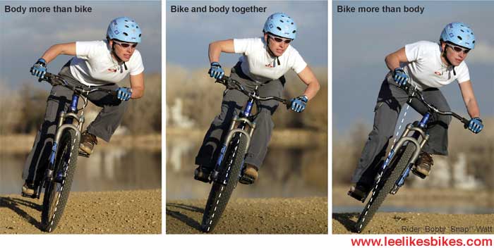

So there's this idea in mountain biking that keeping your weight over the tire contact patch equates to more cornering traction. What I mean is instead of leaning with the bike, you lean the bike under you while staying mostly over the tires (see the right "Bike more than body" image below).
So assuming the bike is leaning at the same angle and only the rider's angle relative to the bike is changing, does tire friction change?
I would think the normal force and side force would remain unchanged regardless of rider position so that F= μ N where N is simply N=mg.
I know rider location alters torque on the system (rider+bike) but I'm not sure that this alters friction in a cornering scenario.

Yeah, I'm assuming the the angle of the tires relative to the ground is constant for the purpose of this discussion.
I think your assumption is wrong. It is the rider that is at the same angle and the bike that leans more. It seems rather clear from the pictures.
I suspect the reason behind it has to do with camber thrust. When a tire leans, it creates a lateral force:
The effect of leaning the bike more means that you don't need to steer the wheel as much to create the needed lateral force. I think this is also clear from the pictures from your post. You could even lean the bike enough to create a need for negative steer.
I suspect the objective is to keep the wheel straight as much as possible. Not sure why, though. Maybe it has to do with the fact that there is a need for countersteering with a bike in a turn. You would want to keep your wheel straight such that you can correct rapidly either way. Just a guess.
Likes DaveE

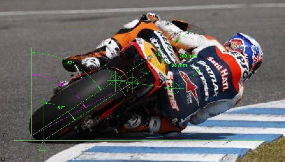

Theory aside, there is experimental evidence that, in the more ideal case with slick tires, and smooth pavement, you will want to lean into keep the bike more vertical. These guys can't win, or avoid killing themselves, when cornering at high speed without doing this. They all are leaning in as much as possible.
It is the rider at the same angle in the pictures. Are you saying it's not possible for the rider to move towards the inside and maintain the same bike lean angle?
Great stuff, but the main reason for getting your body lower on sportbikes/superbikes/MotoGP on paved racetracks is to gain ground clearance for the lean angle. The bikes and tires are near their limits for lean angle, so with the rider doing all they can to lower the CoM, that increases cornering forces and speed.
The day that I can get a knee down on a dirt MTB track is the day that I retire to my couch... :smile:
Likes cjl, DaveE and Lnewqban
Assuming the bike has little effect on CG location (compared to the rider), yes. The angle depends only the lateral acceleration (##\frac{v^2}{r}##).

I believe that improving suspension is the only good reason behind hanging-off for motorcycle racing on pavement prior hard parts of the chassis start dragging.
Once the racer reaches the limit angle of the chassis, hanging off is limited by available clearance between bike and road/track surface.
