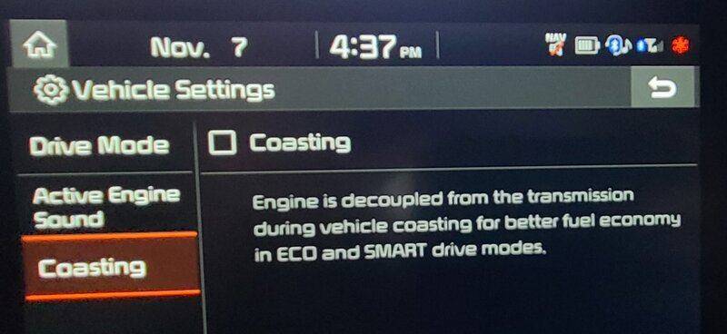

My gas car actually has selectable modes for downhill behavior. You can opt to leave the transmission engaged or to go neutral. It strikes me that neutral is counterproductive since an idling engine is all waste whereas rolling downhill in gear, gravity powers the accessories with zero fuel consumption.
Yes, but cylinder compression and internal engine friction slow you down.
But in practice on downhill you are going too fast so put in gear is better..
Jurgen M said:
Yes, but compression and internal engine friction slow you down.
But we are assuming constant speed. Something will be slowing you down regardless. If not the engine, then the braking system. Or the cops.
Engine braking probably reduces the fuel delivered by the injectors below the idle requirements. (Though my last exposure to automobile engines was in the era of carburetors with venturis). @russ_watters makes the point that engine braking also unloads the engine from any load imposed by the air conditioner and other accessories that might require more than just idle power.

Right, as I said earlier it really doesn't take much of a hill to drop fuel consumption to zero. And even if it doesn't it is still a reduction.
I've verified this with an ECM monitor. They report "throttle" and fuel flow at zero and the coolant cools noticeably in just a 30 second downhill run.
Not so. A car uses considerable fuel while off the gas while in gear. You can tell because of the significantly increased drag if you actually shut off the fuel injectors. Leaving it in gear is engine braking. There's a lot of friction and associated lost fuel efficiency by keeping your engine RPM high while it isn't doing any work. Most of the mechanical friction is in the engine.
I have one favorite spot where I can get from the top of one (usually) gentle hill all the way to the stop sign 16 km away. I can't do that if I leave the thing in gear but foot off the pedals. I honestly have no way of measuring fuel consumption of 22 minutes of engine idle vs 32 minutes of the wheels pushing a high RPM drive train with theoretically sub-idle fuel consumption. At times the engine would definitely be accelerating the car, which sort of disqualifies it as coasting.

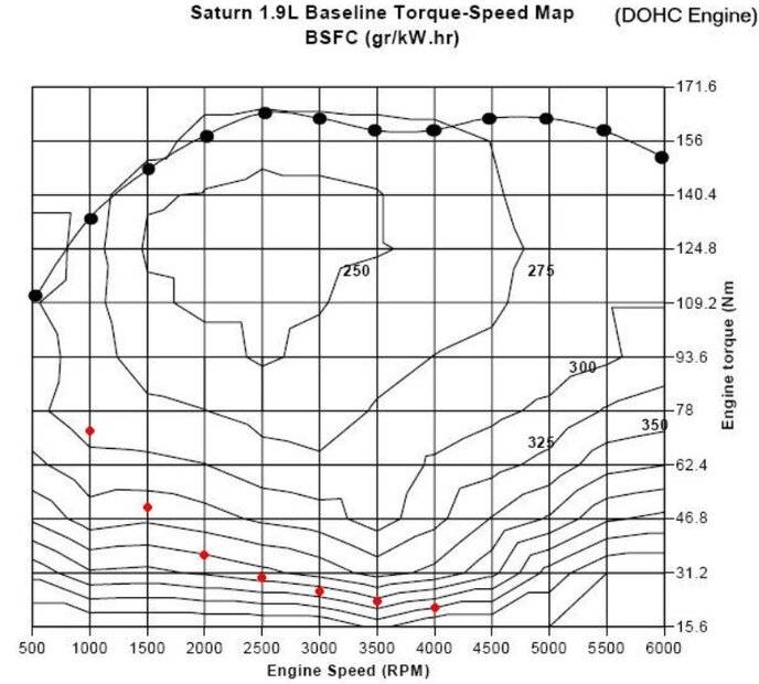

And a few other factors. I made that round trip once per week for 11 years, so got a good idea of what affected the mileage. Headwinds vs tailwinds affected mileage by at least 5 MPG. Temperature had an effect. I averaged 32 MPG in winter, and 38 MPG in summer. The average winter temperature was about 60 deg F lower than the summer average, so 10 deg F was worth 1.0 MPG. A more complete discussion is at: https://ecomodder.com/forum/showthread.php/modding-06-gmc-canyon-17070.html.
The effect of uphill vs downhill on gas mileage is more complex than simple physics energy calculations. Engine efficiency has a large effect. Engine efficiency varies with RPM and the percent torque, and is shown in a performance map. A typical engine performance map is shown below:
The contour lines are lines of constant efficiency. The most efficient operating point is near 2500 RPM at about 125 Nm torque. The red dots are points of 10 hp at various RPM's. Ten hp at 1000 RPM burns about 295 gr/kW-hr, while ten hp at 4000 RPM burns 450 gr/kW-hr, or 50% more fuel to generate the same power. That's only one reason why gas mileage cannot be predicted by only considering the laws of physics.

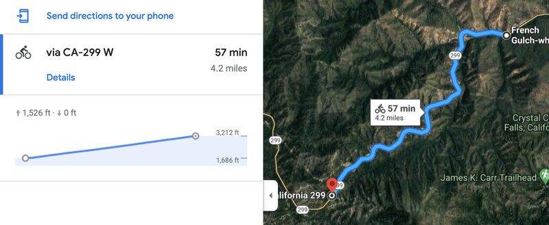

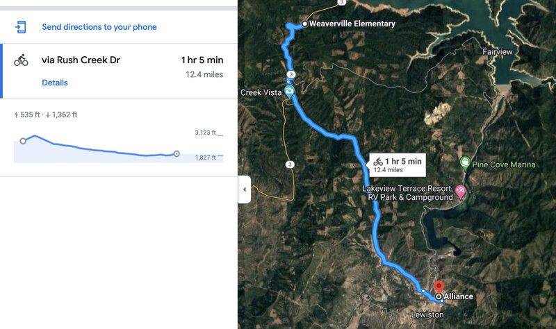

In my car I can regularly get 40mpg even though it’s listed at 33mpg highway. (I do check every time I fill up by dividing the miles traveled by the gallons pumped).
In the mountains, on the downhills it’s beneficial to be in neutral coasting as this drops the engine rpm from around 2500rpm while coasting to around 750rpm.
On the flat highway, I note the lowest rpm that can be achieved while in the highest gear. This results in me cruising at about 61mph even though the speed limit is 70mph. Fortunately the speed limit is 55mph for tractor trailers but they usually go about 61mph, and being a short distance behind one of those helps the fuel economy considerably by reducing the air resistance/drag. Also, turning off the air conditioner and making sure the tires are fully inflated helps. The car is a Nissan Versa.
Only if I drive slowly (40-50mph) uphill in the mountains such that my RPMs don’t exceed 2500, and coast in neutral on the downhills will I get similar 40mpg as I do while cruising at 61mph on a flat freeway.

The article was an interesting read, and I didn't know the fuel injectors would bring the fuel flow to 0% while coasting in gear on a downhill.
That said I don't believe all factors have been considered in the article. When I was talking about coasting downhill in neutral in the mountains, for me, I meant going 60-70mph downhill for 5 miles or so at a time while in neutral on a hill like this:
From what I gathered in the article, even if fuel injectors aren't injecting any fuel at all while the car is in gear coasting downhill, surely keeping the engine turning at 2500rpm with no fuel being consumed is an additional source of drag above and beyond the air resistance and rolling resistance.
If my memory serves, and I do keep the car in gear while coasting downhill, it will lose speed faster than if it was in neutral, and so I might need to push the gas a little bit to maintain speed, whereas if I were to keep the car in neutral, it will maintain speed on its own from the release of gravitational potential energy.
