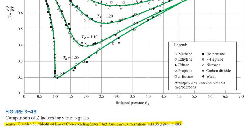

  1. "By hand" using tables from a book and eyeballing values from a table. ##Z=0.64##
  2. Using a Python Library named "GasCompressibility". ##Z=0.61##. Pretty close. I guess the differences are a result of my eyeballed values from a table.

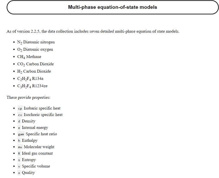

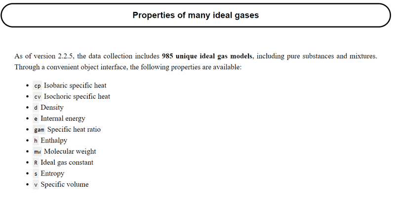

After checking their web more closely, I saw this note:
Is it possible that this library is assuming ideal gas behavior for all gases? That'd explain why I'm getting ##Z=1##. I think that's odd because the library can be used for multi-phase mixtures and saturated gas differs significantly from ideal gas behavior.

Do either of the first two methods use the Pitzer and Brewer acentric factor to get a more accurate value of Z?
The title of your third method specifically indicates ideal gases.

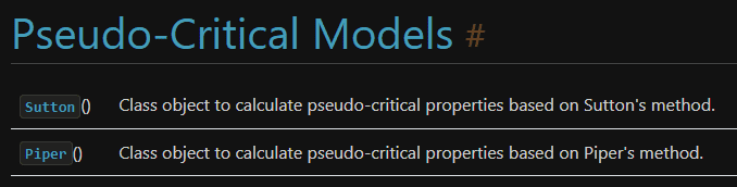

I tried searching for them on the GasCompresssibility webpage and it doesn't show it either. Would this match what you're expecting regarding how things are calculated?
This link also details which model is used to calculate ##Z##.
Yes. I read it but I don't see how that matches the fact that the library is also used for saturated mixtures. The vapor in the mixture is most definitely not behaving as an ideal gas, right?

Juanda said:
I searched the book for those keyworks and they don't show up. Although maybe its mentioned in the source Chemistry book.
These are multi-constant equations.

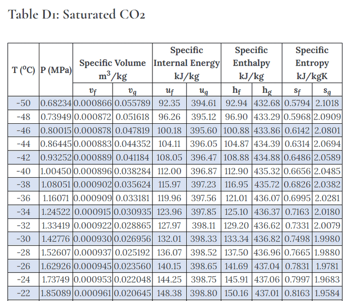

Aren't these kinds of tables (below) obtained experimentally? Maybe PYroMat is using experimental values for the multi-phase calculations and then it switches to ideal gas once it's all vapor?
I'm trying to decide if PYroMat is a library I should get more used to using or if I should discard it. The library GasCompressibility seems useful and reliable since it produced the same result as the "by hand" calculation using the book.

Even if it treats the vapor as an ideal gas, it must use data on the density of the saturated liquid as a function of temperature, and, if you specify the mass fraction vapor, you can get the averaged specific volume of the combination of liquid and vapor.
Tables like this are generated from analytically fitting data, with the fits constrained by thermodynamic relationships. This table takes into account non-ideality. To generate this table, all you need to know the Cv or Cp of the gas as a function of temperature in the ideal gas limit, the PvT real gas behavior of the gas, the Cp of the liquid at low pressures (say 1 bar) and the PvT behavior of the liquid.
