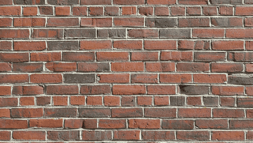

I believe it is pretty low for true brick walls (after all, cinder block walls are used for "sound walls" alongside highways). Is it a true brick wall, or a brick facade layered onto a traditional wood framed wall?
It is atually made of hollow bricks, pretty much like these

berkeman said:
You can tell the difference because real brick walls have a "King Row" every 5th-8th row or so.
I hadn't heard the expression 'King Row' and I looked it up. It's strange - yet another difference between British and US practices - but wood frames and wood inner skins were not common in the UK until recently; "real brick walls" rule! You will find mainly Cavity Walls in the UK, with two 'leaves' (skins of brick or block) with an air gap between them and metal ties holding the two leaves together. Before cavity walls they used double thickness walls, with several methods of bonding them together. Flemish and English bonding used stretcher and header bricks arranged in various patterns. Good for low frequency sound screening because it's mainly mass that counts at low frequency. But LF sound was not a problem before modern music (except for heavy machinery in factories).
Cavity walls can be filled with foam or fibre but that can be problematic with damp, mould etc etc. Nowadays, in the UK there is much more construction in the US style with wood skins inside and brick outside.

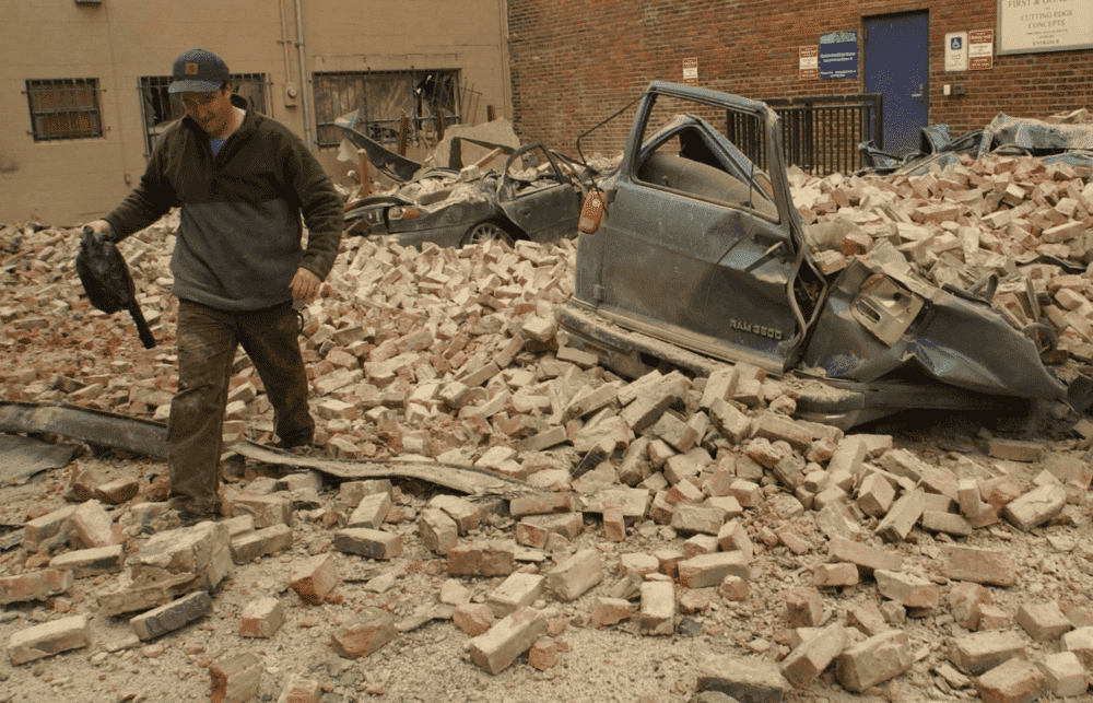

Not here in Earthquake Country! Real brick construction is pretty deadly here, and may even be against modern building codes now. If you see King Rows around here, you pretty much stay the heck out of that building.
Amusingly, the local large Fire Station looks like it's built with brick walls, but if you know to look for the King Rows, you can tell it's just a facade. :smile:
But there are fake "real brick walls" - see the last three pages here.
Yeah, that's insidious, IMO. Brick buildings are a death sentence in Earthquake Country.
https://www.seattletimes.com/seattle-news/politics/will-seattle-at-last-take-action-on-buildings-that-can-kill-when-earthquakes-hit-new-push-in-seattle/
Likes sophiecentaur
