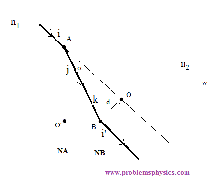

What is the science behind the difference in distance between the emergent Ray and the original path of light before refraction at different angles of incidence using a Ray box and a glass block? i.e bigger angle of incidence equals a bigger distance between those two points than a smaller angle of incidence!
Sorry not a physics specialist!
Are you familiar with geometry? What do you think when you see this image
How will you express ##d## in terms of the other given parameters in that picture?

Yes this is what I'm talking about so in layman terms why is d different at different angles of incidence

Yes it is zero perpendicular to the glass block but it changes at different angles below 90. I suppose what I'm asking is there a relationship between the angle of incidence and refraction from air to glass (in basic GCSE) terminology?

Do you know Snell's Law? (The relation between angle of incidence and angle of refraction?)
When the angle of incidence changes, so does the angle of refraction. The length of path inside the gas plate also changes. Why do you think d must be constant? It is an easy geometric derivation to get the distance d in terms of angle of incidence.
@bmcd , I guess your first keyword for now is the "Snell's law".
