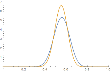

So, if you want to do a Bayesian approach the first thing would be to start with this. How solid do you think this "good word" is? Do you think it is 50% likely to be true, or 80%, or what?
Once you have established how reliable you think this prior knowledge is then you can construct a Beta Distribution that matches that. For example, if you think that the prior is 50% likely to be correct then you could use ##\beta(25,20)## which has only 25% probability of being less than 0.5 and only a 25% probability of being greater than 0.6.
Then, to account for your data you would simply add the 13 successes and 11 failures to your Beta Distribution to get ##\beta(38,31)##. That would be the posterior distribution of the dodge cap accounting for both your prior information and also your data.
Here is the resulting plots of your prior (blue) and posterior (orange) probability distribution curves.
