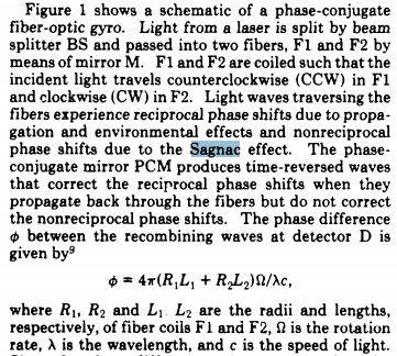

My global Sagnac effect formula, Δt = (l1 + l2)/(c - v1 - v2) - (l1 + l2)/(c + v1 + v2) = 2[(l1v1 + l2v2)]/c2, derived for the very first time for the MGX/RLGs, was also obtained by Professor P. Yeh in 1986, using PCMs:
φ = -2(φ2 - φ1) = 4π(R1L1 + R2L2)Ω/λc = 4π(V1L1 + V2L2)/λc
Since Δφ = 2πc/λ x Δt, Δt = 2(R1L1 + R2L2)Ω/c2 = 2(V1L1 + V2L2)/c2
Self-pumped phase-conjugate fiber-optic gyro, I. McMichael, P. Yeh, Optics Letters 11(10):686-8 · November 1986 
http://www.dtic.mil/dtic/tr/fulltext/u2/a170203.pdf (appendix 5.1)
