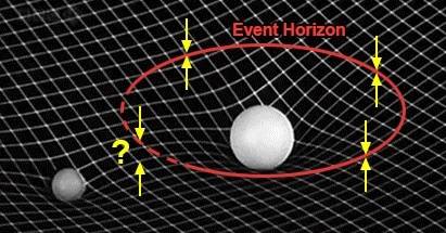

If there is a large mass near a black hole, is the event horizon teardrop shaped? Today I was thinking if it was possible to violate the idea that anything that passes the event horizon is gone forever. I forgot to label my picture, Figure 1 is the top and Figure 2 is the bottom.
I imagine a black hole being approached by a massive hypervelocity star, it's nearing it's breaking point because of the tidal forces, but still in one piece. My thought experiment involved taking a trip on a neutrino that is ejected by the star traveling at nearly the speed of light and enters the black hole at an extremely shallow angle.
The neutrino goes into a spiral path inwards, making one full "orbit" around on the inside. Normally in a black hole, it'll never be closer to the event horizon in the future as it is in the present. [Figure 1] But if there is a large object near it, the gravity of the other object should pull on objects close to the event horizon, wouldn't that cancel out a small part of the gravity of the singularity and allow the neutrino to pop back out? Like how when an asteroid slingshots around the Earth and the gravity from the Moon pulls it away? [Figure 2]
If the event horizon gets pushed back towards the singularity on the side of it closest to the star because of the star's gravity, then on the opposite side, where the gravity of both the star and the black hole are acting, the event horizon should be stretched out. So imagine a relativistic proton approaching the black hole, but if the larger star were not there, is not on a collision course with the event horizon, it'll be ejected, but it passes extremely close to it. [Figure 1] With that more massive star there, it would pass the event horizon, could it make half an "orbit" and come out the other side where the event horizon has been pushed back? [Figure 2]
I know this is classical physics, but since everything is in the same reference frame, I'm thinking that that's ok? If any of this is true, would that also imply that if the black hole has a big object orbiting every close to it, would there be Lagrangian points inside the black hole?

A diagram:

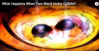

Here is an article containing a simulation of two black holes colliding.
http://www.theevolvingplanet.com/happens-two-black-holes-collide/
A screen shot (taken at 2:14) certainly seems to show your teardrop shaped EHs:
We can extrapolate then, to posit that an object of sufficient mass near a black hole will later the shape of the BH's EH.
I don't see how you could use that to essentially escape. It seems to me, it means there is an even larger volume in which you can find yourself trapped within the EH.
I've seen this guy before, I don't think that's a mathematically sound simulation. Could you link to one of those research papers you mentioned? Here is why I think the simulation is just CGI and not based on actual physics: the teardrop is a mirror image of what I expected it to be. In the screenshot, the two lobes are facing each other, that doesn't make any sense, shouldn't the lobes be facing away from each other? It makes sense that gravity would be strongest when the two black holes are aligned with each other, not when you're in between them. Maybe there is some obscure dragon in GR that I don't understand, but the screenshot doesn't seem to fit my understanding of it.

Exactly, like how in between the moon and the Earth, the escape velocity is slightly less than it is on the opposite side of the planet because the Moon has it's own pull. The moon allows for objects that would otherwise be in death spirals in our gravity well to pop back out. Essentially, creating an L1 point in between them. In a two body system, doesn't there have to be an L1 point and between the L1 point and the center of mass of the larger object, the escape velocity is slightly less than it is everywhere else at the same radius? Like in the diagram that DaveC426913 posted.
