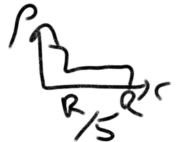

The point is that mass is proportional to radius cubed. I.e. $$M = \frac 4 3 \rho \pi r^3$$ Where ##\rho## is the average density. This gives us
$$ F = \frac{4\rho \pi r}{3}$$ Which tends to zero as ##r## tends to zero for any finite density.
sjbauer1215 said:
So where a nonexistent point at the center has a value of zero, there is no gravity. And yet an object whose size is greater than zero, and at the center of the volume, is suddenly feeling the pressure of the colliding effects of a gravitational acceleration rate of greater than the rate on the surface.
I'm sorry, I cannot make any sense of that. The maths is quite straightforward. Say your planet has radius ##R## and surface gravity is ##g##. There are three regimes:
Inside your inner sphere the acceleration at a distance ##r## from the center is ##100gr/R##.
Outside your inner sphere but still inside your planet the acceleration is ##\left(\frac{99R^2}{124r^2}+\frac{25r}{124R}\right)g##.
Outside the planet it is ##R^2g/r^2##.
Note that the field strength is a maximum at the outer surface of the inner sphere and decreases both inside and outside it.
