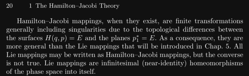

My doubts started by studyng perturbation theory. In the book Canonical Perturbation Theories Degenerate Systems and Resonance, I find the following
The usual books in analytical mechanics don't deal with this.
