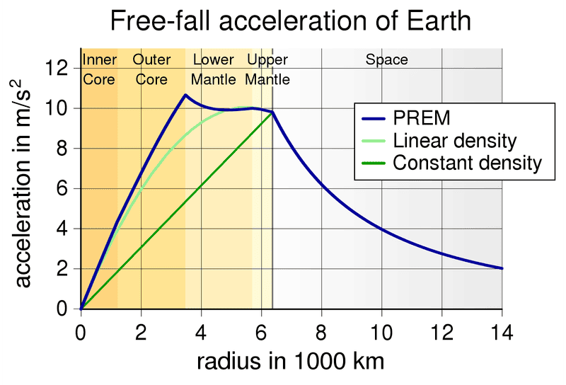

For example does the inverse square law reduce the gravity from Earth's center enough that the ground directly beneath our feet now would exert a greater amount of gravity on each of us?
Inverse square law would reduce the gravity from the parts of Earth that are farthest from our feet.
It'll also reduce the gravity from Earth's center by a lesser amount, but would that be lesser enough so the gravity 20 kilometers under our feet is stronger than the core's gravity or even the rest of Earth's gravity?
I know their gravity strengths would add together, but I'm interested in each area's contribution.
So does the ground directly beneath each of our feet exert the greatest amount of gravity on each of us? Or is the core's gravity (or rest of Earth) still stronger on their own even at its distance away from us?
Here a look at the acceleration of an object in freefall under gravity at different radial distances from the center of the Earth for various models. The blue line (PREM) is what you'll want to look at. You'll notice that there's a small increase in acceleration (corresponding to a greater net force) as we go deeper until we reach the outer core. This is mostly because the core is somewhat denser than the rest of the Earth, so as we approach it the strength of gravity increases even though we have a bit less 'stuff' beneath us. Note that the acceleration goes to zero at the core because gravity is pulling equally in all directions, resulting in no net force, and thus no acceleration.
It's hard to put into words. The ground directly beneath you exerts a greater force in terms of force per mass of stuff, but only because it is really, really close. A kg of concrete under my house exerts a lot more force on me than a kg of material in the core of the Earth. Does that answer your question?
Likes PeroK, syfry and vanhees71
A ton of rock right under your feet will exert a stronger gravitational force on you than a ton of rock ten meters away…. But there’s a lot more rock ten meters away than just under your feet.
If we assume a spherically symmetric mass distribution (that is, the density is a function of just the distance from the core) and add up all the contributions from all the different parts of the earth at different distances from us, we will find that total is the same as if all the mass were concentrated in a single point at the center - proving this is a good exercise.

If I understand what you are trying to get at, you are trying to imagine the gravitational effect of a hemisphere of earth and stone within, let's say, 10 meters of your feet and compare that with the gravitational effect of the rest of the earth.
Perhaps we could try to put a number on how large you would have to make the hemisphere beneath your feet so that half of the gravity on you would come from that hemisphere and half from the rest of the Earth.
That is a rather nasty calculation, especially when one factors in the density variations within the Earth. However, we can get a feel for how the inverse square law works with a problem that is very much more tractable.
Alternate problem:
Let us pretend that we are dealing with a planet that has constant density and the same surface gravity as the Earth, ##1g##. How much smaller would the planet have to be so that its surface gravity would be ##\frac{1}{2}g##?
The volume of a smaller planet goes as the cube of the radius. So if we reduce the radius of the planet by a factor of two, the volume (and mass) of the smaller planet will be down by a factor of eight.
But it will be half as far to the center. So by the inverse square law, the gravitational effect of the mass will be up by a factor of four.
Which gives us the answer we are after. A planet half the size will have half the surface gravity [assuming density is unchanged].
This is also shown by the dark green line in the graphic referenced by @Drakkith in #2 above.
As a crude approximation, we might say that half of the gravity you feel is from the ##\frac{1}{8}## of the earth's volume nearest to you and the other half is from the remaining ##\frac{7}{8}##.
