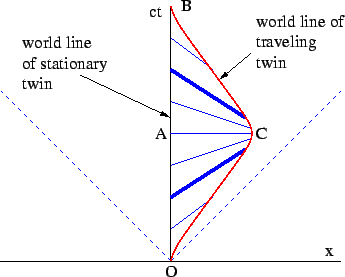

Wes Tausend said:
See the second paragraph in the wikipedia Twin Paradox. There appears to be more than one school of thought amongst the experts, which is why I earlier asked if PF had any 'official paradox consensus' that we must adhere to.
There might be more than one school of thought among the experts about pedagogy--how to present the twin paradox to lay people or beginning students of SR--but there is only one "school of thought" about what SR predicts.
Any further discussion of this (in a new thread, as @Nugatory has pointed out) should definitely be informed by the Usenet Physics FAQ article on the twin paradox:
http://math.ucr.edu/home/baez/physics/Relativity/SR/TwinParadox/twin_paradox.html
This does an excellent job of (a) describing various possible ways of analyzing the paradox, (b) showing how they all give the same predictions, (c) distinguishing between how each twin describes the events using coordinates (which is what is usually discussed) and what each twin directly observes with their eyes or telescopes or instruments (the "doppler shift analysis" section of the article), and (d) providing the most general analysis that subsumes all the others (what the article calls the "spacetime diagram analysis") and which is also the analysis that generalizes to cases where gravity is not negligible, i.e., to general curved spacetimes in GR as well as flat spacetime in SR.
Likes laymanB and Wes Tausend

As far as the twin paradox is concerned, would it be correct to state the problem and solution as such?
1. The events that we are defining to compare differential aging are that of the Earth and space twin originally united as event A, and the reunion of the twins at the same location on Earth as event B.
2. In either of the inertial reference frames (IRF), the Earth twin is not moving through space relative to the spatial components of events A and B, so only the time component of spacetime is changing for the Earth twin.
3. In either of the IRF, the space twin is moving through space relative to the spatial components of events A and B, so both the time and space components are changing relative to the events' spatial location for the space twin.
4. A straight line in Minkowski spacetime is the longest proper time ##\tau##, therefore the longest proper time ##\tau## will be measured by the Earth twin, irrespective of which frame does the calculations?
5. If we know the relative velocity, we can then figure the time dilation using the Lorentz factor $$\Delta t' = \frac{\Delta t}{\sqrt{1-\frac{v^2}{c^2}}}$$ to figure the differential aging. Or we can simply compare the proper times ##\tau## of both twins and work out the relative velocity for the trip. And although the time dilation can normally be applied symmetrically where each twin can claim to be the one at rest, only the space twin in our thought experiment is moving through space relative to the spatial components of the defined events, so that twin's age must be less.
Maybe?? (Crossing my fingers)
@laymanB
Only the Earth twin stays in the same IRF throughout. The space twin changes his IRF at the turn around point.
That's the critical difference.

PeterDonis said:
I've always thought a proper setting of this thought experiment would have the "Earth" twin floating out in space, at rest relative to Earth but far enough away that he doesn't need to fire rockets to stay at rest relative to Earth during the experiment.) An unaccelerated worldline corresponds to a straight line in Minkowski spacetime. Then the statement of yours quoted just above follows
Thanks Peter. It seems to me that without acceleration, the problem is truly symmetrical. The space twin could claim to be at rest while the Earth recedes away at some relative velocity and then the Earth frame would have to change inertial reference frames to come back. The spacetime diagrams would be mirror images of each other along the time axis when drawn from either frame as the rest frame.
Likes nomadreid
In flat spacetime, without acceleration--meaning, without either twin feeling acceleration--there is no way for the twins to meet up again.
No, that won't work. "Change inertial reference frames" means the Earth twin--meaning the twin just floating out in free space, at rest relative to the Earth--would have to feel acceleration. He doesn't. It's the traveling twin that feels acceleration.

laymanB said:
I was referring to the standard twin paradox setup without acceleration (or more precisely, the impossible thought experiment where the constant relative velocity is reached instantaneously, the acceleration of turnaround is ignored, and the deceleration back to Earth to compare clocks is instantaneous).
The acceleration of turnaround is not ignored in this formulation. It is just idealized to occur instantly. It can't be ignored since it makes the traveling twin's worldline not a straight line; instead it's two straight lines with a "corner" at the turnaround. There is no "corner" in the Earth twin's worldline. That's the asymmetry.
laymanB said:
the Earth and its twin switch IRF instantaneously
No, they don't. "Switching IRF" requires a "corner" in the worldline. There is no "corner" in the Earth twin's worldline; the "corner" is in the traveling twin's worldline. See above.
laymanB said:
In this scenario, would not the Earth twin be the younger one according to the original setup (not Peter's version)?
The original setup has the "corner" in the traveling twin's worldline, not the Earth twin's worldline. That makes the Earth twin older when they meet up again.

Sorry, this is the only image I could find on Wiki Commons. I realize that it shows the "corner" as rounded off signifying a more realistic acceleration for the turnaround. This would be the spacetime diagram drawn in the Earth twin reference frame, correct? With his worldline from O to B in a straight line, and the traveling twin's worldline going from O to C and C to B? (Sorry to change the conventions we have been using)
So I was envisioning that if the spacetime diagram drawn in the reference frame of the traveling twin who considers himself at rest the entire time, that is image would be symmetric along the ct axis. Obviously not right.
  • #34
PeterDonis said:
Yes. That should be obvious.
Oh how that I wish it was. I find that most places that teach about the twin paradox make no mention of how to solve it without resorting to acceleration. Including the link you provided in this thread.
EDIT: In post #27, you did say that the acceleration is not ignored, just idealized.
  • #35
There's a difference between a rest frame and an IRF. In a previous thread I analyzed this problem from the traveller's outbound IRF. In this frame, the Earth moves with constant velocity. On the outward leg, the traveller is at rest in this frame. But, on the homeward leg the traveller is also moving in this frame.
The thing the traveller cannot do is associate their rest frame with a single IRF throughout.
Likes laymanB
