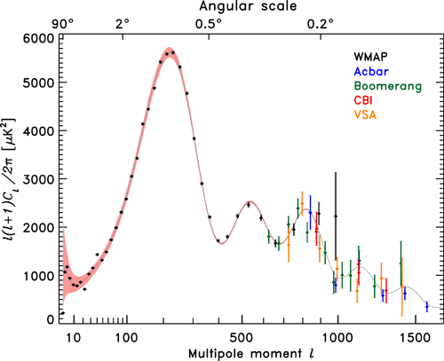

What you might be thinking of is sound as perturbation waves in the pressure field. If you adopt a more general definition of pressure, which may include the analogous pressure field in the cosmological fluid model of the universe, then you can define sound waves within the universe as acoustic oscillations of the universe's density at recombination...
This is pretty standard early universe cosmology analysis, and one of the more famous graphs comes from it:
They are not sound waves, but they are something vaguely analogous.
