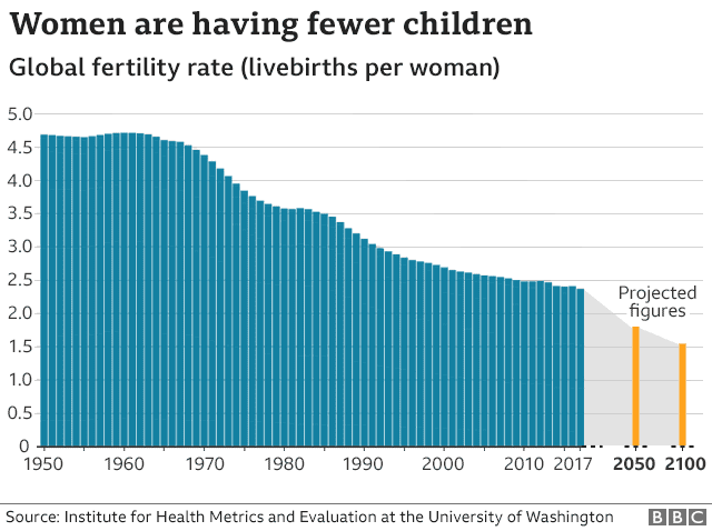

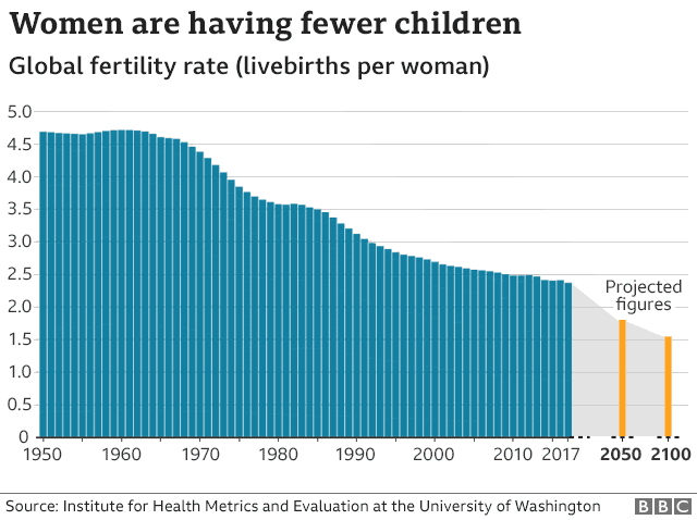

but The universally observed trend of the past 100y or so is that population growth declines as power consumption increases. Most of the developed world now has birthrates below replacement. If the trend continues, shortly global fertility rates will fall below replacement

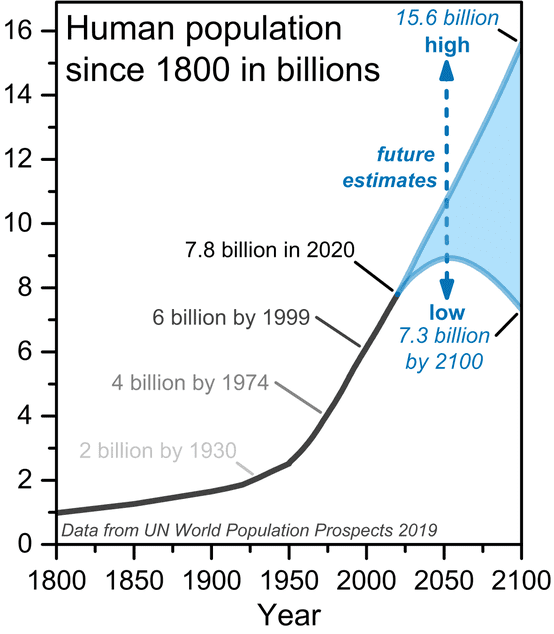

That's the low estimate, but not the only estimate. From Wikipedia
But even by the low estimate, 7 billion is far too large a population.
How many people is too many? That's a difficult question. Existing estimates tend to focus only on food, not on water, habitat, climate and the holistic problem. One possible clue is the famous "hockey stick" curve that shows global CO2 starting to rise around 1800. In 1800, the world population was about 1 billion.
anorlunda said:
That's the low estimate, but not the only estimate. But even by the low estimate, 7 billion is far too large a population.

The estimates are perfectly in agreement. A fertility rate that falls below replacement at some point in the 21st century means the population reaches its maximum in the same range, and starts decreasing at the end of the century. We already passed two important milestones:
* The relative increase per year reached its peak in the 1960s at 2.2% per year. We are down to half of that, 1.1% per year.
* The absolute increase per year reached its peak ~2013.
Most estimates are in the range of 10-11 billion for 2100. That's 50% more than today, but not catastrophically more. We can't support all of them by burning coal and oil, clearly, but with nuclear power and renewable energy the CO2 emissions from energy use can be kept low. Other CO2 sources are still an issue.
