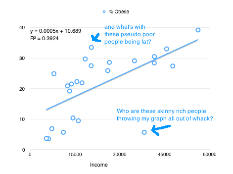

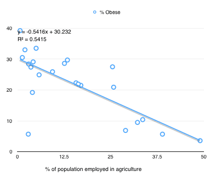

Anyways, in an attempt to comprehend what my t-shirt means, by this coming weekend, I decided to do a little data mining, and plotting...
Code:
variable____    R^2__     equation_(ax + b)
calories____    0.7178    0.022x - 46
rice________    0.6340    -0.15x + 29
all meats___    0.5959    0.25 + 6.1
emp-Agricult    0.5415    -0.54 + 30
cows________    0.4778    0.22x + 13
emp-Service_    0.4567    0.50x - 9.3
chickens____    0.4517    0.63x + 6.2
income______    0.2934    0.0005x + 11
ave temp____    0.2004    -0.53x + 29
fish________    0.0744    -0.21x + 26
leisure time    0.0504    -2.5x + 64
emp-Industry    0.0267    0.29x + 16
working time    0.0097    0.0041x + 21
vegetables__    0.0031    0.0077x + 21
My conclusions were:
1. Given that I have never studied statistics, these numbers are kind of gibberish, but somewhat entertaining.
2. A higher R2 seems to indicate that the data is less random.
3. No matter how many vegetables you eat, it isn't going to make you skinny, if the other 13 variables are not in your favor.
4. I will never understand my t-shirt*. :oldcry:
*Om's "Radical Bayesian" t-shirt:
The OP's hypothesis was that eating chickens makes you fat.
My current hypothesis is that nations with low rates of agricultural employment, and high rates of service employment will make you fat.
How on Earth do you put that into an equation? Do I just plug in the R squares?
ps. Sorry for the thread hi-jack, but I'm serious. :oldgrumpy:

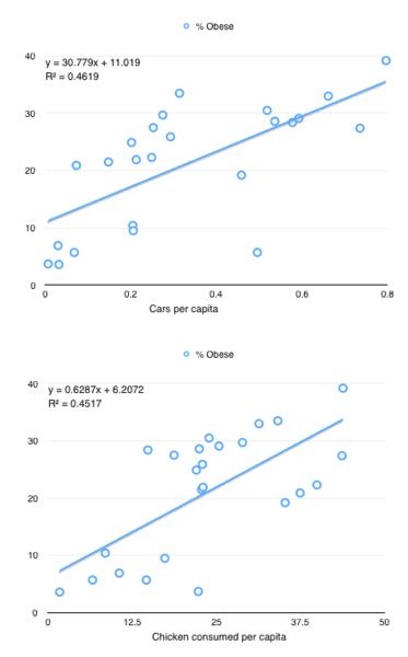

To make my case clearer I've added more graphs. Look again.
http://www.maverickexperiments.com/chicken/chickenFat.html
Even 100% correlation would not make a case at all.
Unrelated: Calculate the correlation instead of putting your plot next to a random 50% correlation plot.

This thread doesn't make much sense. Try plotting fatness vs. number of cars per person, or just vs. GDP per capita. I bet you'll get a much better correlation.
