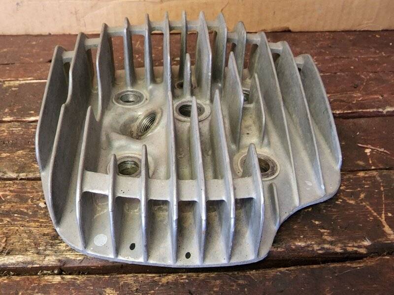

  • #35
And according to eBay, here is one.
