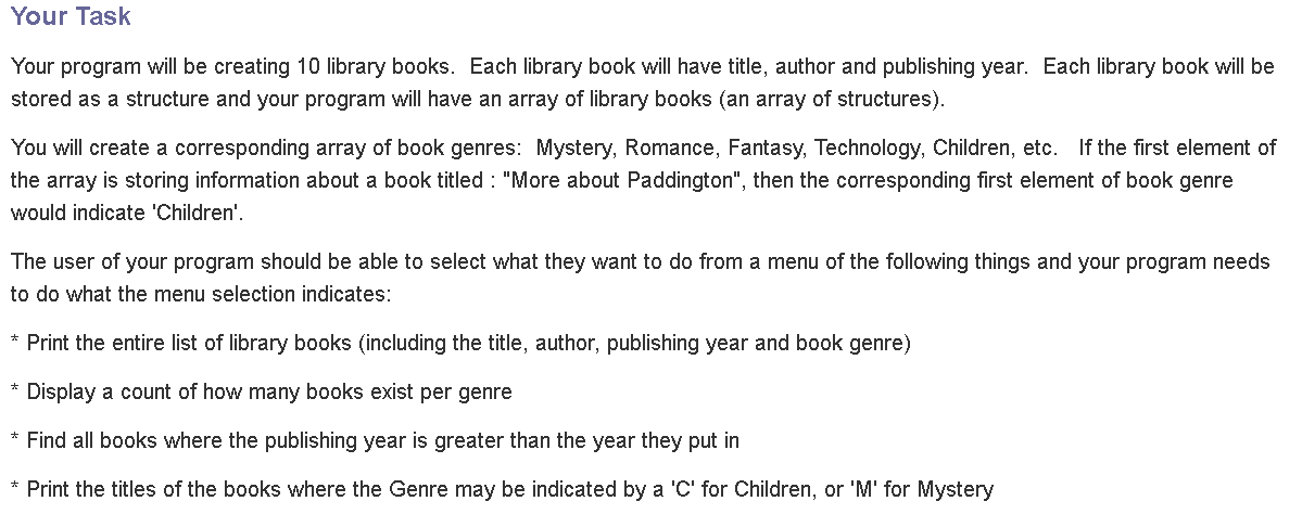

So, like the title says, I'm doing another project. The kicker this time is that I don't even know how to start. Last time I was able to post some code I had already messed around with (and messed up) but this one I'm not even sure how to begin.
I've already done some of the work with structures and arrays through the course but I'm flailing and failing here.
Here are the books I've decided to use. Not that that helps much.
"The Hound of the Baskervilles" Arthur Conan Doyle, published 1902 Genre: (M)ystery.
"True Confessions" Novel by John Gregory Dunne, published 1977 Genre: (M)ystery
"Where the Wild Things Are" by Maurice Sendak, published 1963 Genre: (C)hildren's
"Pat the Bunny" by Dorothy Kunhardt, published 1940 Genre: (C)hildren's
"Hatchet" by Gary Paulsen, published 1987 Genre: (C)hildren's
"The Hobbit" by J.R.R. Tolkien, published 1937 Genre: (F)antasy
"The Lord of the Rings" by J.R.R. Tolkien, published 1954 Genre: (F)antasy
"The Name of the Wind" by Patrick Rothfuss, published 2007 Genre: (F)antasy
"Into the Wild" by Jon Krakauer, published 1997 Genre: (B)iography
"Night" by Elie Wiesel, published 2006 Genre: (B)iography
The program states that the books shall be stored as structures. Does that mean I want 1 structure per book or 1 structure that includes all the books? I'm getting really stressed out here, lol.

I've given up on this front of coding. Post 3 is where I currently am at. I think it is modeled better to see me to the end.
Okay, I've got some code to go along with it. But it's very basic and I don't think it will carry me to the end of this. Especially with the requirement for genres and searching by years thrown in. I'm also not sure how to do part 1 (Printing the entire list of books if the user asks to).

Okay, a second set of code which gives me a menu. Hopefully this will draw some more attention so I can get some help. I'm putting in an effort, I truly am!
I could use some help with menu option 2, 3, and 4.

For part 2, would defining the genres (B, C, F, and M) as integers work?
And then I could call the value from each vector position for bookGenre, if it were = to B, C, F, or M add +1 and then print the value of the int?
Is my logic sound?
I've tried running it this way, but I can't seem to pull it off.
A suggestion: write separate functions for each menu item.
Got part 2 working with this super long strip of code.
