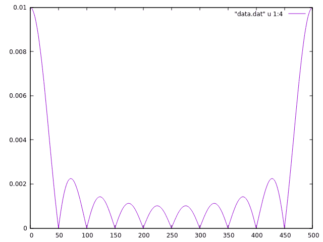

The (computing) task at hand is to take a function [itex]f(x)[/itex] defined at [itex]2N[/itex] discrete points, and use the Discrete Fourier Transform (DFT) to produce [itex]F(u)[/itex], a plot of the amplitudes of the frequencies required to produce [itex]f(x)[/itex]. I have an array for each function holding the value of each function at each value of [itex]x[/itex].
I have 2 questions:
1) Does it make sense to talk of a continuous frequency space when we start with a discrete real space? i.e. Can I let [itex]u[/itex] take any value or should it only take values corresponding to functions with integral periods?
2) What should the domain of [itex]F(u)[/itex] be?

b) I have tried a few plots of [itex]F(u)[/itex]. I've tried with [itex]f(x) = 1[/itex] for [itex]-6<x<5[/itex] and 0 otherwise. I see that the plot is periodic with period [itex]2N[/itex] and with vertical axes of symmetry at integer multiples of [itex]N[/itex]. This seems to support my conclusion in (a). I attach one of my plots of [itex]|F(u)|[/itex] for this [itex]f(x)[/itex]. This was plotted with [itex]N=250[/itex] with (effectively) continuous [itex]u[/itex].

I suppose then, we don't need to worry about representing a given frequency on the discrete grid, and so any frequency can sensibly be plotted. The question of a suitable domain still remains. The periodic nature of [itex]F(u)[/itex] surely means that no particular section of it is more important than another, but then I obviously can't plot an infinite domain. The fact that [itex]F(u)[/itex] doesn't decrease in magnitude with increasing [itex]u[/itex] as a general trend is making me think I've made a mistake.
That's no mistake. Periodic sampling of [itex]f(x)[/itex] has made [itex]F(u)[/itex] periodic as you've discovered!
Thank you! So finally, should I be considering a continuous u, or a discrete u? If discrete then what should the step size be?
My thoughts are that it should be discrete, and the step size should be 1/2, this being because the so-called fundamental period of the system is 2*2N; twice the length of the discrete space. Since the sum has a factor of 1/(2N) in the exponential to account for the size of the space, and the fundamental frequency would be 1/(4N), we're left with the factor 1/2. Discrete, because typically a Fourier transform plots only integer multiples of the fundamental frequency.
Right, the "discrete Fourier transform" is defined for discrete ##u## (the frequency is defined at samples of the continuous function which you plotted ).
Note however that your function ##F(u)## in the frequency domain looks to be periodic with fundamental period 2N (not 2*2N).
So what are you defining as the step size? Do you mean the difference between adjacent ##u##'s or between the actual frequencies (are they cyclic or radian?) that appear in the exponential, or what?
After a bit more research, I've found that the DFT should be thought of as a unitary matrix that maps a vector from the real basis to the sine basis. This makes sense to me I think. From this I conclude that [itex]u\in\mathbb{Z}\in[0:2N[[/itex].
