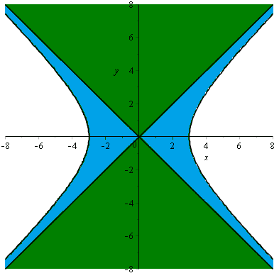

Hello all, I am trying to find and draw the domain of this function:
\[f(x,y)=\sqrt{ln(\frac{9}{x^{2}+y^{2}})}\]
Somehow I find some technical difficulty with it.
I have found 3 conditions:
\[\ln \left ( \frac{9}{x^{2}-y^{2}} \right )\geq 0\]
and
\[\frac{9}{x^2-y^2}>0\]
and
\[x^2\neq y^2\]This led me to understand that maybe an hyperbola is concerned, or a part of it anyway.
I understand that in order to keep
I get
\[\frac{9}{x^2-y^2}\geq 1\]
after applying e. But I am kind of stuck now.
Your help will be most appreciated. I want to draw the domain at the end.

Hello Yankel!
You have:
\[\frac{9}{x^2-y^2}\geq 1 \qquad \qquad (1)\]
Since the numerator is positive, the denominator will have to be positive as well:
\[x^2-y^2>0 \qquad \qquad \qquad (2)\]
This also covers your observation that $x^2\neq y^2$.
It means you can multiply both sides in (1) with $x^2-y^2$, keeping the orientation of the inequality sign.
\[9 \geq x^2-y^2\]
So you are left with:
\begin{cases}
x^2-y^2 &\leq& 9 \\
x^2-y^2&>&0
\end{cases}
$$0 < x^2 - y^2 \le 9$$
These are the 2 areas bounded by the hyperbola:
$$\Big(\frac x 3\Big)^2-\Big(\frac y 3\Big)^2 = 1$$
the line:
$$y=x$$
and the line:
$$y=-x$$
Is this correct then ?
(the blue area - which doesn't include the lines themselves of y=x and y=-x)
Assuming that your original equation should actually be:
\[f(x,y)=\sqrt{\ln(\frac{9}{x^{2}-y^{2}})}\]
with a - sign instead of a + sign, yep, that would be correct. :)
