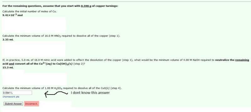

attached
http://imgur.com/CiUX9
n/a
I got the first 3 answers. But I don't know what this is asking for. What is CuO. Where did that come from. Is \n't it supposed to be Cu(OH)2?
[itex]CuO + H_2O \rightarrow Cu(OH)_2[/itex]
It is just hydrated form, nothing to worry about.
I would put it as
Cu(OH)2 -> CuO + H2O
copper hydroxide easily decomposes, but copper oxide doesn't react with water.
