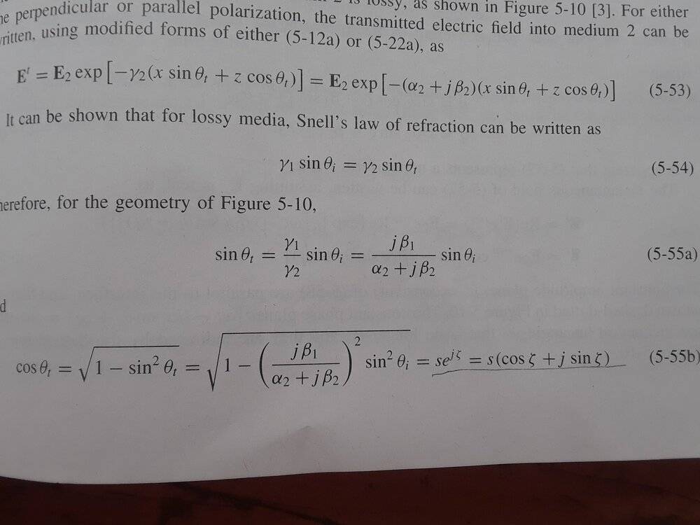

My textbook for Advanced Electomagnetics, by Balinas has this identity.
cos θ = se^(jξ) = s( cos ξ + j sin ξ ).
I have no idea what they are saying. Is there an S funtion I'm not aware of?
I've looked back and forth, and he doesn't seem to explain it's use.
I've inserted a picture of the page, to provide context.
Hope I'm in the right section.

I assume ##j^2=-1##, right ? Then s is magnitude of complex number ##cos\theta_l## and ##\zeta## is its angle in Gauss plane.

s is just a constant, and they use Euler's formula to convert the complex exponential.
Likes jedishrfu
So they are just saying that cos θ can be se^(jξ) = s( cos ξ + j sin ξ ). Where s is any old constant?
They're just decomposing cos θ into a real and imaginary part?
Likes jedishrfu
Yes.
