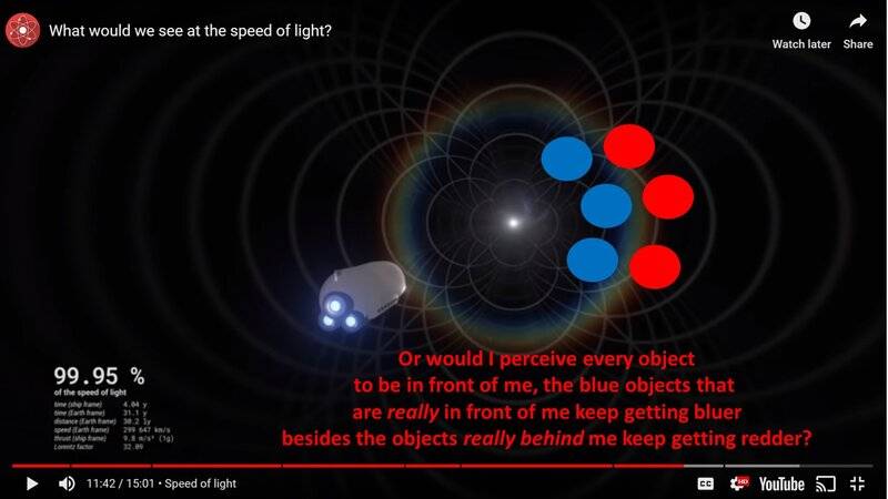

Let me try and recast the question a different way. I'm sitting in my ship. I'm going near lightspeed (I'll use the near lightspeed reference of 99.95% the speed of light in the video above). Physically, millions of light years far ahead of me there are physical blue objects; millions of light years behind me are physically other objects. I know the objects behind me are reddening because I move away from them. If I turn my head to look behind me at these reddening objects (my eyesight is ant-parallel with the ship's motion), will I see them there? Or, if I keep my eyes ahead of me, parallel with the direction of motion of the ship, will the objects physically behind me appear in front of me now but continually getting redder?
No math. If its math that hasn't been done or no one knows/wants to do the calculation, I will simply assume it is an unanswered question of relativity. The video above, in its opening scene, said that all the math and calculations had been taken care of in the video. Plus, for what I need to do, I need to explain this concept without the math, as it is for educational instruction and no one in my audience will understand the math anyway.

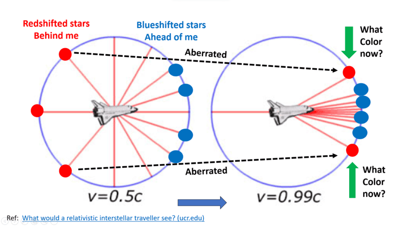

Directly in front is blueshifted. Directly behind is redshifted. At some intermediate angle there is no Doppler shift. Is your question what that angle is? If not then I am not sure what the question is.

Just to show what seems required for an all vector approach, we have in frame of stars (suppressing z, giving vectors in component form as (t,x,y)):
a light 4 momentum of ##\vec p = E(1,\cos \theta,\sin \theta)##
a ship 4-velocity of ##\hat u = \gamma(1,v,0)##, which is also ##\hat t'## of the ship.
You also have, for the ship ##\hat x' = \gamma (v,1,0)##, and ##\hat y' = (0,0,1)##. This is just a vectorized equivalent of the Lorentz transform. Then, we know that the following must be true:
##E' = \vec p \cdot \hat t'## and ## \cos \theta' = -(\vec p \cdot \hat x') / (\vec p \cdot \hat t')##
These give: $$E' = \gamma E (1-v \cos \theta)$$ and $$ \cos \theta' = \frac {\cos \theta - v} {1 - v \cos \theta} $$
These give you full generality of Doppler and aberration, explaining the 'searchlight' effect.

I thought about the responses here a little bit more. Here's what I came up with.
Orodruin said:
without proper reference to what you are moving at that speed relative to. If you are moving at 0.9995c relative to the stars in the galaxy, you can just as well describe things as you being stationary and the stars moving at 0.9995c relative to you.
Yes, the above is fine. The stars physically behind me and in front of me are rest with respect to each other. Me in my spaceship (frame) move such that those stars move with respect to me. The stars physically in front of me move towards me at constant velocity of 0.9995c and the stars physically behind me recede from me at that same speed. Also, I would consider the frame assumptions of the video mentioned above.

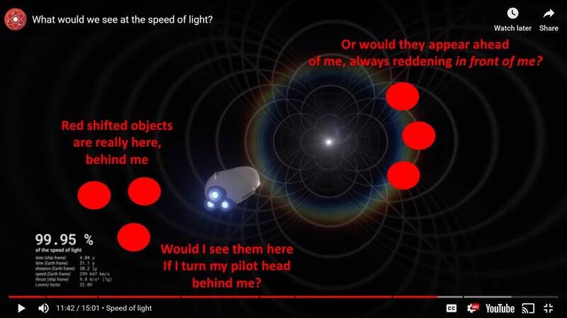

Would that look something like this?
Apologies I couldn't get 0.9995c as we were talking about before but this should be fine for a picture. Actually, this one comment of Orodruin may have led me to ask my question even more simple than what I initially asked. When the redshifted objects appear in the forward light cone (and these objects are not directly behind me but maybe in the rear view and off to the side), do they appear red-shifted in the light cone now? Where the green arrow points and it says "What Color now?" --> that is what I am asking. I don't know if:
1) The photons from those used-to-be-red-shifting objects would appear to be approaching me from the front and therefore would be blue-shifted now
or
2) maybe those objects appear to be in front of me but keep getting redder because they are actually behind me.
Sorry, I hit reply too soon and I can't fix this post. I'm in "Edit" mode now where I can't get the quote feature to work and I did want to add about Ibix comment about the changeover angle which would support choice number 2. That quote was:
"You can read off the redshift as a function of angle and compute the red/blue shift changeover angle easily at that point."
which I can't reconcile to Dale's quote above.
Also, I retract the math comment. I know what I was trying to say, but it didn't come out the right way here. Yes, math is important here
Aberration does not change energy. Thus if a star is redshifted per the rocket, that is true weather you consider the angle to the rocket in the star frame or in the rocket frame. So in the star frame, all red shifted stars are behind the rocket. In the rocket frame some of these are in front. The boundary is the particular angle where no shift occurs. In the star frame, this is behind the rocket. In the rocket frame it is in front of the rocket. The two angles are symmetric about the perpendicular, related by ##\theta’ = \pi - \theta##.
And just to make sure, PAllen's Equations on Monday night at 10:36 pm are the same (or nearly so) as the equations under discussion between Ibix and Odonriun Monday afternoon before? I don't remember these transformations for awhile and want to read up on them again. A website with a description of this math would be greatly appreciated.

Let the star rest frame be S and the ship S'. Using the primed frame, a light pulse approaching the ship has ##p'^a=(E',-E'\cos\theta',-E'\sin\theta',0)##, where ##\theta'## is the angle away from the ship's straight ahead direction. An observer at rest in S has ##u'^a=(\gamma,-\beta\gamma,0,0)##, where ##\beta=v/c## is the ship's speed as a fraction of ##c## and ##\gamma=1/\sqrt{1-\beta^2}##, so measures the light pulse to have energy ##E=\eta_{ab}p'^au'^b=\gamma E'(1-\beta\cos\theta')##. Thus the redshift seen by the ship as a function of angle away from the nose is $$\frac{E'}{E}=\frac{f'}{f}=\frac{\sqrt{1-\beta^2}}{1-\beta\cos\theta'}$$You can check that this reduces to the textbook longitudinal and transverse Doppler shift formulae when ##\theta'## is 0, 90° and 180°. Note that it is 1 when ##\cos\theta'=\frac 1\beta(1-\sqrt{1-\beta^2})##. Everything nearer the nose than this is blueshifted and more so the closer to the nose you get, everything outside that angle is redshifted and more so the closer to the tail you get.
Aberration is easier to do the other way round. In the star rest frame, the ship has four velocity ##(\gamma,\beta\gamma,0,0)## so its ##x'## direction is ##x'^a=(\beta\gamma,\gamma,0,0)##. A light ray arriving at the ship from angle ##\theta## has four momentum ##p^a=(E,-E\cos\theta,-E\sin\theta)##, which has component ##-\eta_{ab}x'^ap^b=-E\gamma (\beta+\cos\theta)## in the ##x'## direction. Since this must be equal to ##-E'\cos\theta'## we can derive ##E'/E=\gamma (\beta+\cos\theta)/\cos\theta'##. Then we can use our previous expression to get rid of the ##E'/E## and get $$\cos\theta'=\gamma^2\frac{\beta+\cos\theta}{1-\beta\cos\theta}$$
Hopefully that agrees with @PAllen.
Here we agree except for two formalities - sign convention and which frame's angle to use in formulas. For @Albertgauss, this is a skill you have to learn comparing different texts/sources - conventions will be different and superficially different formulas are most often consistent (unless one source has made an error). So far, @Ibix and my results are identical except for differences in these choices of convention.
I chose to write this in terms of ##\theta## rather than ##\theta'##. The formulas are equivalent, though it is not obvious algebraically. It can be seen by noting that if ##E=\eta_{ab}p'^au'^b=\gamma E'(1-\beta\cos\theta')## as derived above, by computing in S, you must have:
##E'=\gamma E(1-\beta\cos\theta)##. This then gives my form of the Doppler formula (noting that my angle sign convention is the opposite of yours).

Here you have goofed in your elimination algebra. If you do it right you get something equivalent to my aberrations formula (delta sign conventions). I did this in a way that needed much less algebra, but I worked out that your approach would come out the same with correct algebra. The ##\gamma^2## is wrong.
