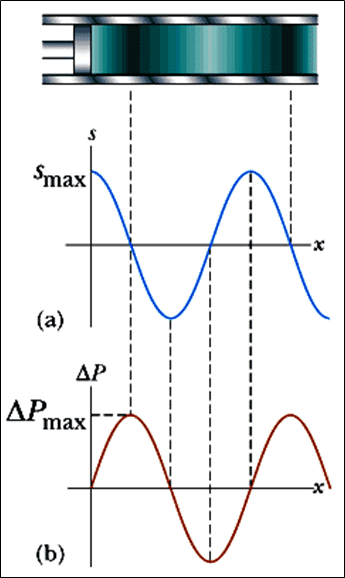

Okay shall change it to fbeat = Vf/2v. Because a wave equation is y(x.t) = Acos(kx-wt). And y represents the displacement of a particle from the equilibirum point. However in longitudinal wave, like sound wave, we can represent the wave in terms of a particle displacement or the pressure variations in the fluid where ΔP = BkAsin(kx-wt), where B is the bulk modulus of the fluid and k is the wave number (2π/λ). Then when the particle displacement from the equilibrium is 0 (displacement node), the pressure variation is the highest (pressure antinodes). That 2 equation have a phase difference of λ/4. So I'm asking that the question refers the node as a displacement node, or a pressure node. In a pressure node I assume there is not variation in pressure, thus you can't hear anything in a pressure node? While if you are in a displacement node, the variation in pressure is the largest thus the sound will be the loudest?

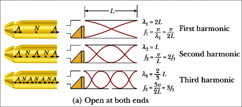

Yeah they alternate. The wave formed between the 2 speakers is a standing wave with 2 open ends? So the displacement nodes are λ/4? Is kind of hard to explain so I'll use a picture.
As per your picture, successive nodes are λ/2 apart, and successive antinodes are λ/2 apart.
The question asks how frequently, not how long to the first one.
Okay I get what you mean. So that is why it does not matter whether is an open end because each successive nodes/antinodes are always λ/2 apart?
Yes.
