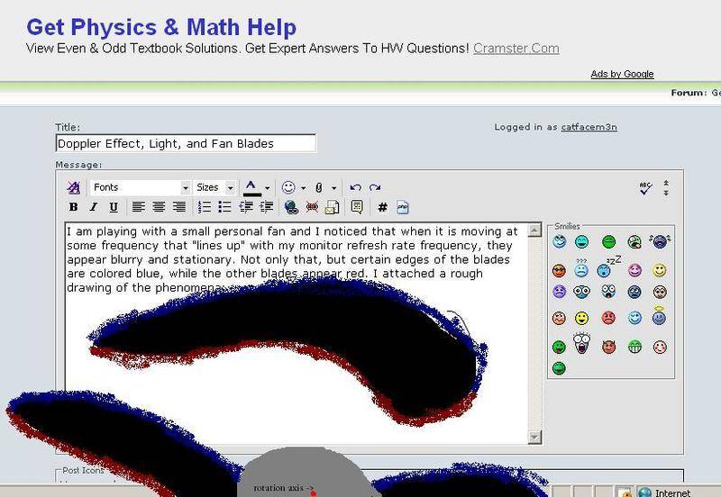

I am playing with a small personal fan and I noticed that when the blades are moving at some frequency that "lines up" with my monitor refresh rate frequency, they appear blurry and stationary, but with altered shapes. Not only that, but certain edges of the blades are colored blue, while the other blades appear red.
I attached a rough drawing of the phenomena. I know this picture is hard to make sense of, but when this little fan is rotating, it seems to make weird clumps of black that are always bounded by the circle of the blades, but are not necisarrily the same shape as the blades. Also this picture is made as if you were me looking at the phenomena as I started writing this post.

Welcome to PF, Catface. The Doppler effect can't have anything to do with this, since the light source is neither approaching nor receding. You're seeing a stroboscopic phenomenon. It will appear different from a normal strobe because the light is coming from a different area of the screen and different coloured pixels with each 'flash'.
Closely related to "Moiré patterns".
Another point, the distortion of the shape of the fan blades is due to the fact that the screen is not flashing as a whole. Rather the display lines scan down the screen thus you are seeing horizontal cross sections for each scan line of the screen corresponding to the (shadow of the ) fan at slightly different angles as it turns.
I understand the scanline thingy.
I don't understand why the top of the each figure created by the blades is always blurred blue and the bottom of each figure is always blurred red.
Also, in my picture, the figures are approximately 3/4 opaque, and the edges of the figures taper off like a gradient in photoshop. I can see through to the screen behind is the concept.
I looked up Moiré pattern (http://en.wikipedia.org/wiki/Moiré_pattern) and see the relatedness, thanks cesiumfrog.
Also, I didn't realize that the screen flashed not as a whole; this makes the shape of the figures clearer to me, but I still don't feel comfortable with these exact shapes, and the divergent points between the blue and red blur: I think these blurs are related to the "path" of the screen refreshing. thanks jambaugh!
further note: my picture, as my brother nicely stated, is horrible. It dosen't do this phenomenon justice. I'll try to get this documented, assuming that a camera won't add another demension of weirdness.
thanks all!
A still camera won't mess anything up, but a video sure would. It would just be compounding the effect with a new scan phase. By the bye, your first attachment hasn't been approved yet, so we can't see it.
I didn't realize that the top was always blue and the bottom always red. The blades must in some way be acting as a prism to direct the incoming light according to frequency. I don't know anything about optics, though, so I'll leave that for someone else.

Here is a link to my picture:http://aycu26.webshots.com/image/16225/2000221396030596128_rs.jpg .
Also I tried it with a fan with ridgid blades and the same thing happened. Two different materials (flat plastic for the first fan; pressed aluminum for the second fan i test) and the same effect. I'm starting to believe that this has to do more with the monitor than the fan.
