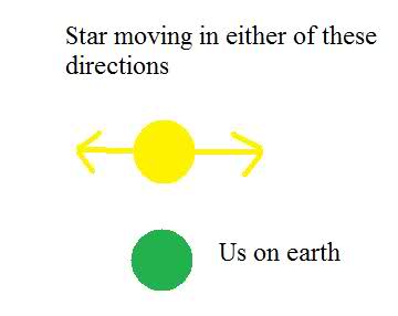

"Astronomers are able to measure the motion of a luminous body in a direction directly along the line of sight much more accurately than they can measure its motion at right angles to the line of sight. This technique makes use of the Doppler effect."
Now I did some research and this is what I understand currently
If the star is moving away like in this diagram you get Doppler shift
However if the star moves sideways like this there is no Doppler shift
If my understanding is correct then my question is why does the sideways motion not produce a Doppler shift its still getting further away ?
There will still be a Doppler shift due to time dilation (the transverse Doppler shift).
Assuming the motion is exactly sideways to the line of sight, then at that point it's not getting further away.

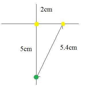

I don't see how this is, consider this example
If the star moves sideways 2cm it gets 0.4cm further away from us ?
What am I not understanding ?

Realize that the star will be gazillions of miles away. It's not going to change its position that drastically any time soon.
At the moment when the star is moving sideways to the line of sight (the first position in your diagram) it has no component of velocity in the radial direction: the instantaneous rate of change of its distance from us is zero. As the star continues to move in a straight line (let's say it does) and reaches some point where it is no longer moving sideways to the line of sight (the second position in your diagram), then it will have a component of velocity in the radial direction.
So just to confirm my understanding ...
At the initial moment it starts moving at a right angle to us sideways it has no velocity in that direction, hence it is no further away so there is no Doppler shift
However later on in time it gets further away from its initial position and is no longer moving at a right angle to us so does 'produce' Doppler shift
It has no velocity component toward or away from us.
Even if the motion is completely sideways there will be a Doppler shift--this is called the transverse Doppler shift and is due to time dilation. (This transverse shift is generally smaller and more difficult to detect.)
Right. (With the caveat that any motion will produce some kind of shift.)
If you ignore the transverse Doppler shift and only consider the longitudinal Doppler shift, then your understanding is perfectly correct.
