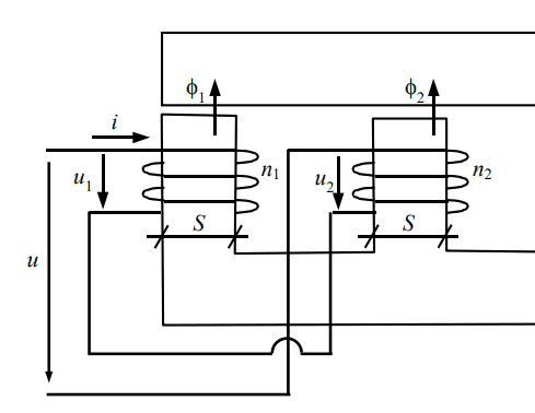

However, the final case is where I drop the ball:
So here I had previously calculated the mutual inductance and found out it was indeed negative. The series connection also suggests to me that we have discordant coupling (by dot convention) and therefore the series inductance is going to be:
$$L = L_{11} + L_{22} - 2 |L_M|$$
But now my book gives the answer:
$$L = L_{11} + L_{22} - 2 L_M$$
And since ##L_M## is negative this will originate different values.
I feel so confused right now, I have no idea how am I supposed to solve problems right this because I keep getting different answers. Can someone help me organize my line of thought. I think I understand concept of mutual inductance. What I don't understand is this thing with absolute values and series connection and I don't really know what to do.

For your final case, look at the way the current flows through each inductor. It should be apparent that ##\phi_2## will be pointing in the opposite direction to what they've shown. Trace the path that the flux from coil one will take through the laminated core. Will it add to or subtract from the flux of coil 2?
