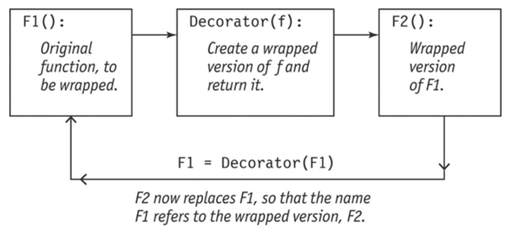

3) Wrapper Function
I have read about decorators as being functions that take another function and extend their behavior without explicitly modifying it. As a practical example from the topic of ML, is the library Keras a wrapper to the library tensorflow? Keras is often called an API for tensorflow but I wonder if it is actually a wrapper...

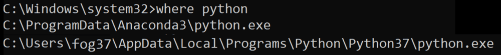

4) Different installed Python versions
When typing where python at the prompt, I see that there are two Python interpreters in different locations:
Which one of the two interpreters does the IDLE use? I think it uses the one in the Python37 folder. How can I check that?
When I install modules, those modules will not work with both Python interpreters, correct? Which version will they use?
What if I removed the version of Python in the Anaconda3 folder? Would it create an issue when I run Jupiter notebooks or other things inside the distribution?
You could describe Keras as a wrapper for Tensorflow, but it is definitely not a decorator because there is not a 1:1 correspondence between Tensorflow methods and Keras methods.
You could try renaming it and seeing if it still works.
It's hard to say with Windows - it is all down to the somewhat mysterious %PATH% environment variable, however it is likely that any packages you install through Anaconda will only be visible to Anaconda's Python interpreter.
Probably. Why would you want to do that? If you really want to use IDLE then why not use it from Anaconda?
