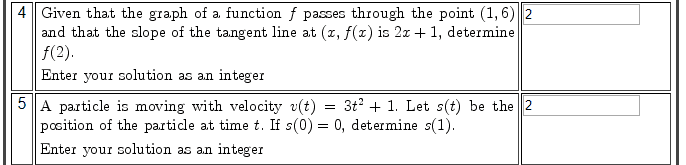

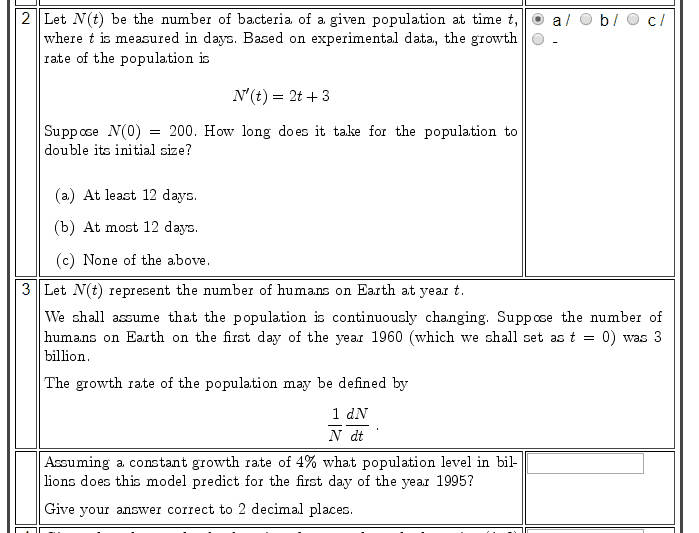

So here is a thing. If I get at least 6/10 questions in this homework I will get 100% in this semester's homework which is equivalent to 20% of the maths module. So could you double check these questions? Also I wouldn't mind some help with q.3 I got a weird answer of 11,8 billion.

2.) Correct.
3.) I would begin with:
\(\displaystyle \frac{1}{N}\d{N}{t}=\frac{1}{25}\) where \(\displaystyle N(0)=N_0\)
Integrate:
\(\displaystyle \int_{N_0}^{N(t)} \frac{du}{u}=\frac{1}{25}\int_0^t \,dv\)
\(\displaystyle \ln\left(\frac{N(t)}{N_0}\right)=\frac{t}{25}\)
\(\displaystyle N(t)=N_0e^{\Large{\frac{t}{25}}}\)
With $N_0=3,\,t=35$, we find:
\(\displaystyle N(35)=3e^{\Large{\frac{7}{5}}}\approx12.17\)
4.) I get a different answer. You've made a minor slip in your working, but your method is sound.
5.) Correct.

Ah c=4 in q4
So f(2) = 2^2 + 2 + 4
= 10 ?
Thanks.
ertagon2 said:
Ah c=4 in q4
= 10 ?
Thanks.
Yes, that's what I got as well. :)
About q.3
This is what I did:
\(\displaystyle N(t)=Ae^{kt}\)
\(\displaystyle N(0)=Ae^{k(0)}=3\)
\(\displaystyle A=3\)
\(\displaystyle N(1)=3e^{k(1)}=3*1.04\)
\(\displaystyle 3e^{k}=3.12\)
\(\displaystyle e^{k}=\frac{3.12}{3}\)
\(\displaystyle (k)ln(e)=ln(1.04)\)
\(\displaystyle k=ln(1.04)\)
\(\displaystyle N(t)=3e^{ln(1.04)t}\)
\(\displaystyle N(35)=3e^{ln(1.04)(35)}\)
\(\displaystyle N(35)~11.84\)
Why is this wrong and what does\(\displaystyle \frac{1}{N}\frac{dN}{dt}\) mean in the context of the question?
ertagon2 said:
About q.3
This is what I did:
Your formula can be simplified to:
\(\displaystyle N(t)=N_0\left(1+\frac{1}{25}\right)^t\)
This is mathematically equivalent to an investment that is earning 4% annual interest compounded once per year. However, if the interest is continuously compounded then we have:
\(\displaystyle N(t)=N_0\lim_{n\to\infty}\left(\left(1+\frac{1}{25n}\right)^{nt}\right)=N_0e^{\large{\frac{t}{25}}}\)
Your model is discrete, whereas we are told to use a continuous growth model. :)
