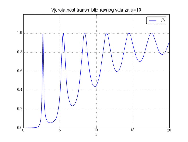

Well look at the probability of transmission (once you've found the transmission coefficient), and try to plot it for various distances of the potentials.
You should get some interesting behavior ;)
I think Flugge has something simmilar in it...
HINT: resonant scattering :)

Still try to look at positive V_0, and plot the probability for transmission, the graph is pretty epic :)

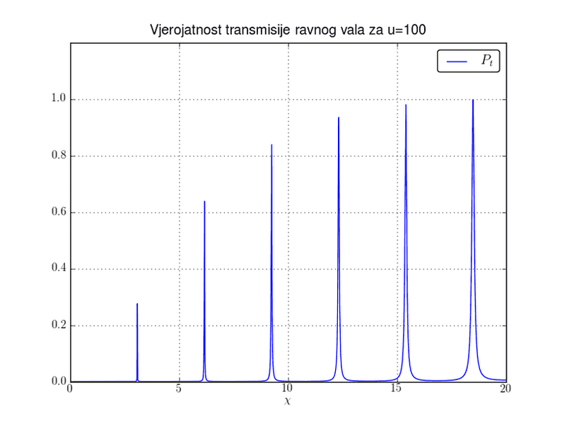

Because this is the case with delta peaks at certain places. As you change the height and distance of the potentials you get resonant scattering.

The graph shows the probability (transmission coeff. absolute squared) vs the kR, R is the distance and k is wave number (it's assumed that your incident wave is plane wave).
