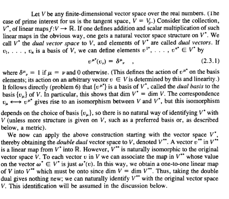

Mathematically, for finite dimensional vector spaces, there is a natural isomorphism between a vector space V and its Double Dual V**. Does this men that V** is always the original V ? Or simply that V** is a vector space with the same properties or structure as V ?
Hi
I believe I understand the concept of a vector space V and its dual V*. I also understand that for V finite dimensional, there is a natural isomorphism between V and V**.
What I am struggling to understand is - Does this natural isomorphism mean that V** is always IDENTICAL to V (identical meaning it IS V) ? In other words have you come right back to the original vector space V ?
In the book General Relativity (by Robert M Wald) he writes the following (page 20) - "Thus taking the double dual gives nothing new. We can naturally identify V** with the original vector space V. This identification will be assumed in the discussion below".
Is this always the case or is he just assuming this is the case in his particular context ?

I was thinking to read his definition. I only just received a copy of Wald and have not yet read through it other than finding and reading the following

The dual ##V^*## of a vector space ##V## is the space of bounded linear maps from ##V## into ##\mathbb{R}##. (Vector spaces can actually be over any field, not just ##\mathbb{R}##, but we'll restrict to vector spaces over ##\mathbb{R}## here since those are the ones relevant to GR and hence to Wald's book.) So the double dual ##V^{**}## is the dual of ##V^*##, i.e., the space of bounded linear maps from ##V^*## into ##\mathbb{R}##, which is the space of bounded linear maps from (bounded linear maps from ##V## into ##\mathbb{R}##) into ##\mathbb{R}##. The existence and structure of the double dual, and its isomorphism to ##V##, is therefore independent of any specific realization of ##V##.

Yes, and it's even "canonical", i.e., you can establish the isomorphism without reference to the choice of bases of ##V## and ##V^{**}##. This is not the case for the isomorphism between ##V## and ##V^*## for a general vector space. There you need a basis and its dual basis to construct an isomorphism. That changes if you have a vector space with a fundamental form (or even a scalar product). For these a canonical isomorphism between ##V## and ##V^*## exists.
