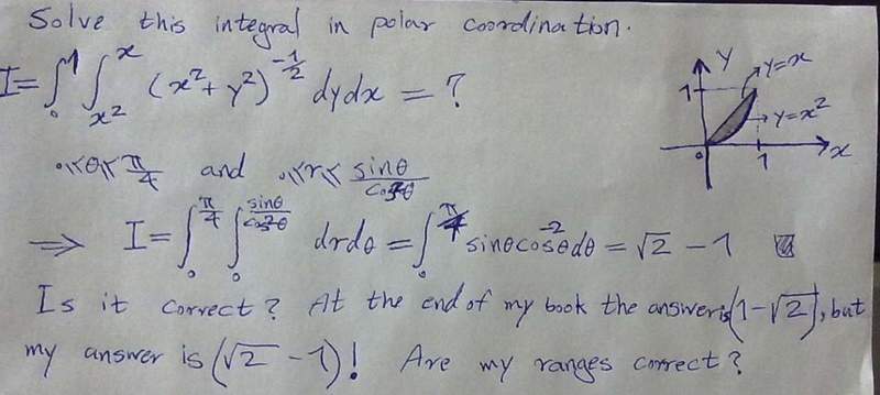

Please tell me if I am wrong. I suspect about the ranges. Are my range corrrect?

Dear Susanne217,
Thank you very much for your reply, but i have already added [tex]dA = r dr d\theta[/tex]
to get the result. If you calculate it you will see that I had already added it! But my problem is the ranges. I suspect about the ranges.
The quantity you integrate (that is '1') is always positive.
An integral is basically a sum, so a sum of positive terms cannot turn into something negative.
The result of the book [tex](1-\sqrt2 \cong -0.41) [/tex] is negative, so it is wrong.
[tex]=\int_0^{\pi/4} \int_{0}^{\frac{sen\theta}{cos^2\theta}} dr\: d\theta [/tex]
[tex]=\int_0^{\pi/4} {\frac{sen\theta}{cos^2\theta}} \: d\theta [/tex]
[tex]=\left[{\frac{1}{cos\theta}\right]_0^{\pi/4} [/tex]
[tex]=\sqrt2-1 [/tex]
Your result is ok.

Thank you very much for the notification about "positive". But would you please tell me what your idea is about the ranges? especially about the ranges of "r". Are you sure that my ranges are correct?
Yes they are correct because in a polar-cartesian system:
the system
[tex]y = x tg\theta[/tex]
[tex]y = x^2[/tex]
gives [tex]x = tg\theta[/tex]
[tex]r = \sqrt(x^2+y^2)= tg\theta \sqrt(tg^2\theta+1) = tg\theta / cos\theta = sen\theta / cos^2\theta[/tex]

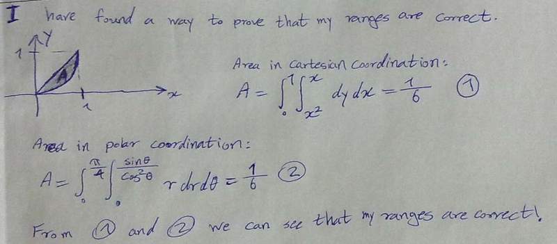

Dear Quinzio,
Thank you very much for your help.
