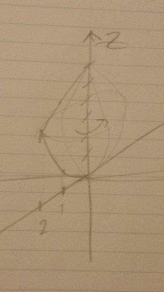

Problem 1: Use double integrals to find the volume of the solid obtained by the rotation of the region:
##\triangle = \left\{ (x, y, z) | x^2 \le z \le 6 - x, 0 \le x \le 2, y = 0 \right\} ## (edit) in the xz-plane about the z axis
Volume = ##\int_a^b \int_c^d f(r, \theta) r dr d\theta##
When I draw this solid, I get a cone who's base is a circle with radius 4.
The height, z, is from z = 4 to z = 6. The sides of the cone are the line 6-x, rotated around the z axis.
##D = \left\{ (r, \theta)_p | r: 0 \rightarrow 4, \theta: 0 \rightarrow 2\pi \right\}##
##f(r, \theta) = 6 - r\cos(\theta)##
V = ##\int_0^{2\pi} \int_0^4 6 - r\cos(\theta) rdrd\theta##
##=\int_0^{2\pi} \int_0^4 6r - r^2\cos(\theta) drd\theta##
##=\int_0^{2\pi} 2r^2 - \frac {r^3}{3}\cos(\theta) d\theta## ...evaluate (r = 4) - (r = 0).
when i typed \right|_0^4 it didn't work..
##= \int_0^{2\pi} 48 - \frac {64}{3}\cos(\theta) d\theta##
##= 48\theta - \frac {64}{3}\sin(\theta)## ...plug in ##\theta = 2\pi## into the expression and subtract ##\theta = 0##.
##= 96\pi + 0 - (0+0)##
##= 96\pi##
but this answer looks way to big for the solid I drew.. where did I first go wrong?

That's not what I get. Why are you ignoring the lower limit ##x^2##?

btw, vela is right, note that you will get a paraboloid cut by a plane, not a cone.

I can't remember why I ignored it.. I've redrawn it though and can't think of a reason to ignore it.. Here's my sketch, let me know if its not clear I'll upload again
and if this is the case I would integrate the paraboloid and cone separately, but before that, I know you said the surface is a paraboloid, but did you mean a paraboloid in addition to the cone, or just a paraboloid?

For every ##r## and ##\theta##, there's a column of height ##f(r,\theta)=z_\text{max}-z_\text{min}##. You want to figure out what that ##f## is for this case and the limits of the integrals.

$$z_{max} - z_{min} = (6-x) -x^2$$ which in polar coordinates is $$-r^2\cos\theta - r\cos\theta + 6$$
Volume = $$\int_0^{2\pi} \int_0^2 (r^3\cos^2\theta - r^2\cos\theta + 6r) dr d\theta$$
$$= \int_0^{2\pi} [-\frac{r^4}4\cos^2\theta - \frac{r^3}3\cos\theta + 3r^2 ]_0^2 d\theta$$
$$= \int_0^{2\pi} -4\cos^2\theta - \frac83\cos\theta + 12 d\theta$$
$$=[-4(\frac \theta2 + \frac {\sin(2\theta)}{4}) - \frac83\sin\theta + 12\theta]_0^{2\pi}$$
$$=[-\sin(2\theta) - \frac83\sin\theta + 10\theta]_0^{2\pi}$$
$$=20\pi$$
This answer seems reasonable to me.. (I compared it to the volume of the rectangular prism that contains it)... am I right?
You shouldn't have the cosines in the integral. The expressions ##6-x## and ##x^2## for the upper and lower bounds are valid only in the ##xz##-plane. When you rotate that region around the ##z##-axis, the heights aren't going change with ##\theta##.

So looking at the previous example, they used cylindrical coordinates..
So
##f(r,\theta) = z_{max} - z_{min}##
##z_{max} = 6-x## But x = r since y = 0.
So ##z_{max} = 6 - r##.
##z_{min} = x^2 = r^2## since x = r.
So ##f(r,\theta) = 6 - r - r^2##.
So Volume = ##\int_0^{2\pi} \int_0^2 (6-r-r^2) r dr d\theta##

I got 8π/3 with that integral, but doing it the way I told you before I got 32π/3. I'm not sure if it's right, anyways I still don't understand, why the function is the difference of z's, though I understood the procedure you did afterwards, but I can't connect why should the function be that difference.
I just did it and got ##\frac {32\pi}{3}## for the integral in post #14
Volume = ##\int_0^{2\pi} \int_0^2 (6r - r^2 - r^3) dr d\theta##
##= \int_0^{2\pi} [3r^2 - \frac {r^3}{3} - \frac {r^4}{4}]_0^2 d\theta##
##=\int_0^{2\pi} 12 - \frac 83 - 4 d\theta##
##= \frac{16}{3} \theta ]_0^{2\pi}##
##= \frac {32\pi}{3}##

Oh yes, I just forgot a four,because I had taken r2 as common factor. Then it seems it's right :)
CollinsArg said:
I don't understand why the function would be a difference between the two z's, is there a visual way to see this?
Plot ##z=6-x## and ##z=x^2## in the ##xz##-plane. Remember that you're rotating the bounded region around the ##z##-axis.
