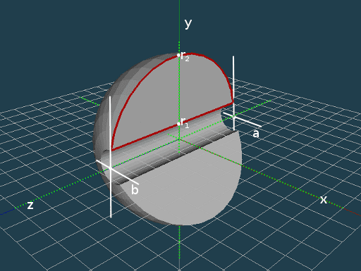

Here's what I'm talking about:
The ball is, here, approximated by a polyhedron.
A wedge has been cut out of the ball for clarity.
a and b are limits of integration chosen to exclude the end-caps.
Notice that z=a is not the same as z=r2?
I've suggested solid of revolution method, but you can also slice this parallel to the x-y plane - each slice will be a disk with a hole in it with thickness dz.
Each disk has inner radius r1 and an outer radius r(z) and thickness dz.
The volume of each disk is [itex]\pi (r^2(z)-r_1^2)dz[/itex] - the total volume is the sum of all the disks. Just stick an integration sign in front of the expression :)

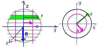

One more picture...The left figure is the side view, it is sliced, every slice has the thickness Δz. The right figure is the horizontal the cross section of the green slice: two concentric circles, with radii r and a. The inner circle is the hole, you need to find the area A between the circles, as the volume of the slice is ΔV=AΔz. r is obtained from the position z of this slice and the radius of the sphere, R:
[tex]r^2=R^2-z^2[/tex]
The area of the slice at height z is
[tex]A(z) = (r^2-a^2)˛\pi[/tex].
You can get it by integrating in polar coordinates, but I hope you are allowed to use the formula for the area of a circle. To get the volume of the whole thing, you need to sum of the volume elements, ΔV=AΔz, that is, calculating the integral
[tex]V=\int_{-Z}^Z{A(z)dz}[/tex]
You have to integrate from -Z to Z: Z is the height where the cylinder crosses the sphere [itex]Z=\sqrt{R^2-a^2}[/itex].
ehild
