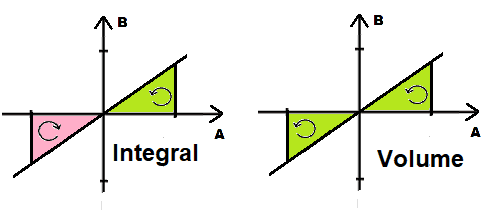

Areas and volumes are orientated quantities: surrounding them clockwise results in the opposite sign as counter clockwise. If you keep the orientation, i.e. the sign, then volumes can cancel each other. This happens to ##\int_{-a}^a x\,dx## since you walk around the two areas in different orientations (along the positive x-axis). If you set up the double integral correctly (suited parametrization), this shouldn't happen in that case. However, you denied to show us your computation although being asked for.
If you are interested in the physical area or volume, you have to add the absolute values of all subareas or subvoluminae, or carefully parameterize the way around the area. Roughly speaking it is ##dx\wedge dy## versus ##dx(t) dy(t)##.

Yes, I did. I only have the impression that we do not get through to @dyn, so I gave it a shot. My main goal was to speak about the concept of orientation, since this is a property which runs through entire physics.
