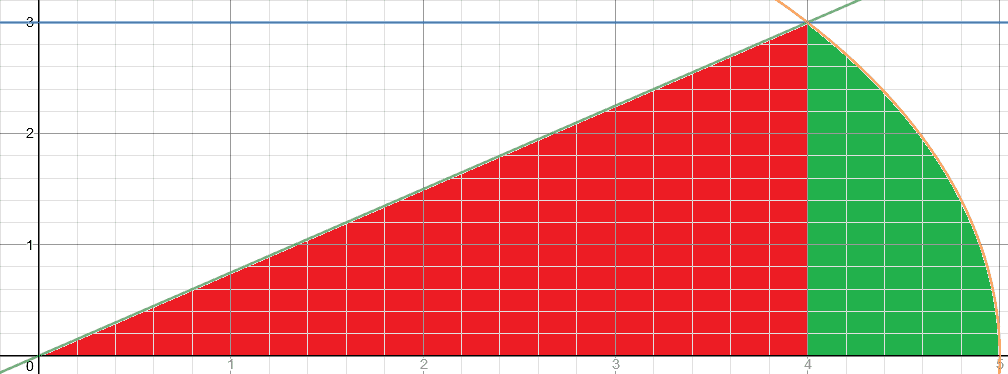

I must evaluate the following double integral over the region R. I do not understand the limits of integration given the following equations.
Let S S = double integral symbol
S S x dx dy
Limits of integration for x:
From (4y/3) to sqrt{25 - y^2}.
Note: Why is the variable y in the radicand? Shouldn't it be sqrt{25 - x^2}?
Limits of integration for y:
From 0 to 3.
I was able to reduced the double integral to a single integral S.
S [(25 - y^2)y]/2 - [(8y^2)/9]y dy from 0 to 3.
My answer is 225/8.
The textbook answer is simply 25.
Is the textbook answer correct? If so, why?
This is how I would evaluate the given integral:
\(\displaystyle I=\int_0^3 \int_{\frac{4}{3}y}^{\sqrt{25-y^2}} x\,dx\,dy\)
\(\displaystyle I=\frac{1}{2}\int_0^3 (25-y^2)-\left(\frac{16}{9}y^2\right)\,dy\)
\(\displaystyle I=\frac{25}{18}\int_0^3 9-y^2\,dy\)
\(\displaystyle I=\frac{25}{54}\left[27y-y^3\right]_0^3=\frac{25}{54}\cdot54=25\)

Can you show me how to integrate this same function over dydx?
Sure, so what we need to do here is examine the region $D$ over which we are integrating...which can be expressed by the inequalities:
\(\displaystyle 0\le y\le3\)
\(\displaystyle \frac{4}{3}y\le x\le\sqrt{25-y^2}\)
Now, in order to reverse the order in integration, we will have to break $D$ up into two regions as follows:
\(\displaystyle I=\int_0^4 x\int_0^{\frac{3}{4}x}\,dy\,dx+\int_4^5 x\int_0^{\sqrt{25-x^2}}\,dy\,dx\)
\(\displaystyle I=\frac{3}{4}\int_0^4 x^2\,dx+\int_4^5 x\sqrt{25-x^2}\,dx\)
\(\displaystyle I=\frac{1}{4}\left[x^3\right]_0^4+\frac{1}{2}\int_0^9 u^{\frac{1}{2}}\,du\)
\(\displaystyle I=16+\frac{1}{3}9^{\frac{3}{2}}=16+9=25\)

Brilliantly done! Why two integrals for dydx and not dxdy?
Well, if you look at the region $D$, you can see that integrating in the original order (with horizontal segments), the left and right bounds of each segment are along the same curves all the way up from $y=0$ to $y=3$, but reversing the order and using vertical segments, we have the same bottom boundary from $x=0$ to $x=5$, but the upper boundary is one curve on $0\le x\le4$ and another curve from $4\le x\le 5$. And so to integrate in that order, we must use 2 integrals. :D
