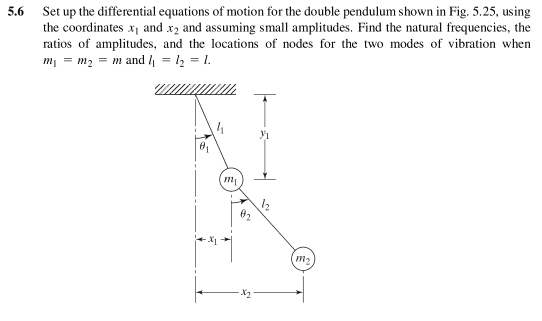

I need help to understand this problem taken from Mechanical Vibrations by S. Rao
I know that the equations of motion could be obtained in various ways, for example using the Lagrangian, but, at the moment, I am interested in understanding the method he used. In particular, if I'm not mistaken, he used moments equilibrium about point O and point ##m_1##. Here's my questions:
1- Why in the moments equilibrium about the point O (equation E1) he considered only the forces acting on ##m_1## as if ##m_2## were not there and also just the moment of inertia of ##m_1##?
2- But above all, in the equation E2, where does the highlighted term ##m_2⋅l_2(l_1⋅\ddot\theta_1)## come from and what does it represent?
3- I have a lot of problems when I'm asked to find equations of motion of a system of particles (like in this case) or of a rigid body, so I need some good resources (textbooks preferably) where I can find all the tools I need to understand and solve this kind of problems.
Thanks !
Equation E1 comes from ##\sum \tau = I \alpha## applied to just ##m_1##. So, ##I## is the moment of inertia of just ##m_1##.
The effect of ##m_2## on ##m_1## is via the tension force ##Q## in the lower rod.
Equation E2 can be derived from ##\sum \tau = I \alpha## applied to ##m_2## and taking the origin for moments to be the instantaneous location of ##m_1##. But, the frame attached to ##m_1## is an accelerating frame. So, there will be a fictitious force acting on ##m_2## that contributes to the moments acting on ##m_2##.

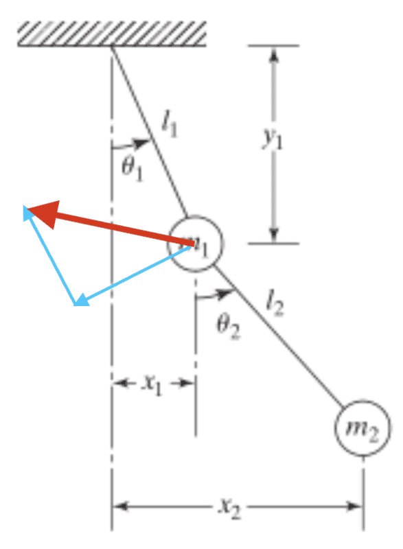

In the lab frame, the acceleration of ##m_1## can be decomposed into a tangential and a radial component:

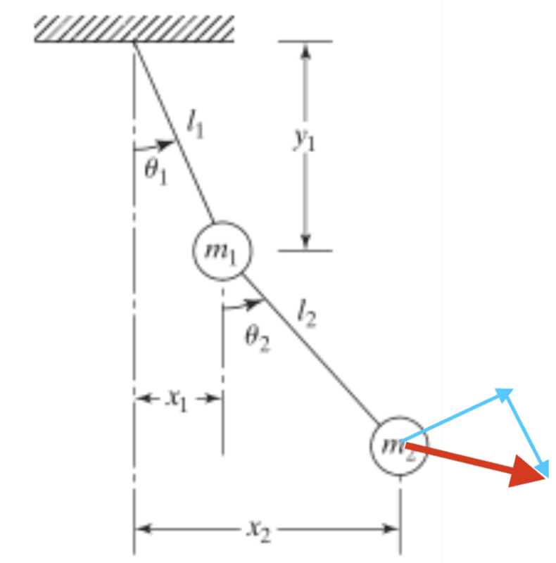

In the frame of ##m_1##, we must add a body force of ##-m_2\vec{a}_1## to the particle ##m_2##, whose components look like negated multiples of the components of the acceleration,
Note that the blue components are parallel and perpendicular to ##\vec{l}_1##, not ##\vec{l}_2##. So the total force on ##m_2## in the non-inertial rest frame of ##m_1## is the weight, plus the tension, plus this inertial force.
In the small amplitude regime, the we approximate for the purposes of computing the torque of the inertial force that ##\vec{l}_1 \parallel \vec{l}_2##, and as such the component of torque due to this inertial force out of the paper is ##m_2 l_2 (l_1 \ddot{\theta_1})##.
