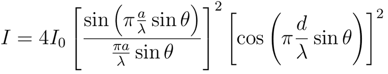

In case of a single slit, the diffracted intensity changes with θ as
[tex]I=I_0\left(\frac{\sin\left(\pi \frac{w}{\lambda} \sin\theta\right)}{\pi \frac{w}{\lambda} \sin\theta}\right)^2[/tex]
The amplitude of the double-slit pattern is modulated by the single-slit one, which has its minima at sin(θ)=±mλ/w, m=1,2,3,4...while the maxima of the double-slit interference pattern are at sin(θ)=±kλ/d, k=0,1,2,3,... The maximum of the interference pattern is missing if it is at the minimum of the single-slit pattern.

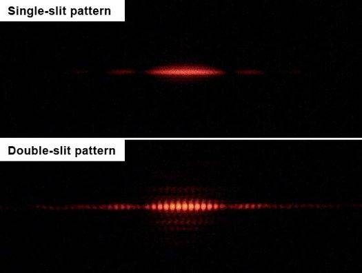

In the second picture, the small bright dots are the interference extrema. See where they are missing.

An interference maximum disappears if it is at the same position as the zero of the diffraction pattern. That happens if d/w is a rational number. Best seen when an interference maximum is at the first minimum of the diffraction pattern, so d/w is integer.
If you see the resultant two-slit pattern for d/w=3/2, (attachment) the first maxima are quite shifted with respect to the interference maxima. It is not clear what the problem means on missing interference maximum, and why d/w=3/2 is the suggested solution. Interference maximum is missing at the second minimum of the diffraction pattern, where it looks rather two little maxima with a minimum in between.
I have seen quite many related problems and every time missing maximum meant the interference maximum at the position of the zero of the single-slit diffraction pattern.

What do you mean on f(x)? After the double slit, the intensity in the diffracted beam depends on the diffraction angle theta,
a is the slit width, (w here) d is the distance between the centres of the slits, lambda is the wavelength.

Put x = πd sin(θ)/λ, A = w/d. Peaks and zeroes of I will be the same as the peaks and zeroes of |f(x)|, where f(x)=sin(Ax)cos(x)/x. If we drop the /x, the zeroes will be the same (except an extra one at x=0) and the peaks will shift a little away from the origin.
