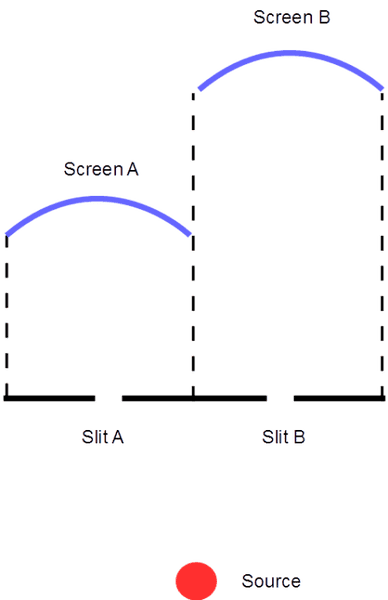

The following occurred to me:
If we have slit A with a screen A, and slit B with screen B, both A en B setting isolated from each other. Now, screen B is twice as far behind its slit as screen A from its.
We now fire an electron that passes boh slits. Then after a while, the the electron could hit screen A. The probability is 50% that it actually does.
If the electron does not impact screen A, the probability it will impact screen B is 100%!
So, if the electron does not impact screen A, it always impacts screen B.
On the other hand, if screen B is passed, then screen A must have been hit.
So, what does select which screen, A or B, will be hit? If it is collapse, why does screen A collapse the wavefunction 50% of the time, and when it doesn't, why does it collapse at screen B 100% of the time left? Or do both screens collapse 50% of the time and is there retrocausality from B to A? Or is there no collapse? Is there a non-local effect? Et cetera. Or is it just the way it is (do the math and so forth :wink: )
It does resemble entanglement to me. Is that correct?
Sorry if I misunderstand completely.

In my example setup there are no extra detectors. The screens are the detectors. I am wondering why:
  • Screen A absorbs only 50% of the particles, while screen B always absorbs (all of the leftover) particles.
A view on this is that screen B equally absorbs only 50% of its particles, and screen A is the one absorbing the leftover 100%. A symmetrical situation, but mutually exclusive. So this resembles to me the collapsing of two entangles particles, where neither is determining the other's measured value.
The local interaction between particle and screen doesn't seem to explain what is happening (of course). :smile:
Can you post a drawing of what you mean ? Again, it sounds like you have a totally different setup as thte one I read from your description. A screen as a detector ? why not call it a screen, then ?
I do call it a screen. It was ment to explain to Ostrados, who talked about detectors. (He talked about measurements, I assumed wrongly detectors I see now).
You can imagine the left side as a screen and the right side too.

In my setup the 'screens' are ment to be physically separated. So then there is no interference pattern on either screen, right? In that case my issue #8 applies.

My point is more or less: if the electron hits screen A, then it won't hit screen B, and vice-versa. So they are mutually exclusive events, and I was wondering how the electron makes the choice for screen A or screen B,or what is making it for it. :wink:
P(A) = P(~B) = 1 - P(B)

Imagine that, in your setup, the electrons are fired at precise time intervals, with a determined speed, and that you know immediately when an electron hits the screen. After each firing, you will either detect the electron at screen A after a certain amount of time, or a little bit later at screen B. Nothing weird there. After having done this a million times, you look at where on the two screens the electrons hit, and you will find an interference pattern, which looks as if each electron went through both slits an interfered with itself. The results are consistent with the QM prediction, where the wave function evolves through all of space, and thus there can be interference because of the two slits, but detection always takes place randomly at one particular point on one of the screens. Generally speaking, QM has nothing to say about which path the electron actually took in each case.
  • #31
Are you sure? The screens are physically separated! (boxed)

Then I misunderstood the picture in post #13. If there is a divider, then there is no interference.
entropy1 said:
So, what makes screen A decide to let 50% of the electrons go? Then screen B obviously decides to keep 100% of the ones let through by screen A, while it is an exactly identical screen. (I realize screen A and B are physically separated - I hope you understand what I mean)
Then it is simply a question of probability. Right after the slit, there is a 50% probability of the electron being on either side. The electron is in a superposition of being in the A "box" and the B "box." Once a detection is made, that superposition goes away.
If the distance of the two screens from the slits is so different that not detecting the event at A after a while tells you that the electron is flying towards B before hitting the screen, then you can see A as always making a detection, even if no electron is observed.
  • #34
By "physically separated" do you mean that there is no path from slit A to screen B, or from slit B to screen A because the middle dashed line in your picture is a solid barrier? If so, there will be no interference pattern on either screen because for any point on either screen there is only one path available. But that's not how you drew your picture.
  • #35
Yes.
No, I realize my mistake.
