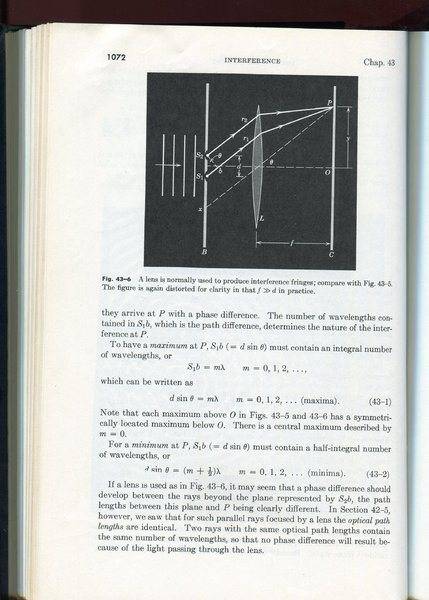

From my Resnick & Halliday

You're entirely right, and I mis-stated - jumped the gun. :))
For the lens-less case the expression is d sinθ = (m+1/2)λ and sinθ = y/D
For the lens case the expression is still d sinθ = (m+1/2) but with sinθ = y/f. Can you make that out in the figure I sent you? I know it's not very legible. The essence is that y/f = tanθ instead of y/D = tanθ. And in both cases we approximate tanθ = sinθ since θ is assumed small.
In other words, with the lens the spacings on the screen is proportional to f instead of D. The lens case does remove the requirement (assumption) that d << D however so it's better in that sense, and therefore usually used.
I'll look at the diffraction case later today.
