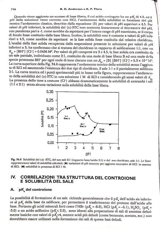

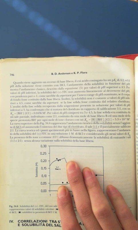

Hi, I have a doubt about calculating the solubility of lamivudine (3TC). Suppose you have an excess of free base lamivudine (B) in solution. An equilibrium is generated between B in the aqueous phase and B in the solid phase, i.e. in solution and the base body. As we acidify the pH by progressive addition of blood, meanwhile, it will be dissociated, according to its acid / base balance, to dare BH +. The maximum concentration of B in water, for [BH +] ~ 0 (even if the 0 in chemistry nn exists) is precisely the intrinsic solubility, S0. Total solubility, as it is known, for pH> 4.5 is ST = + [BH +] = S0 + S0 * [H3O +] / Ka = S0 * (1+ [H3O +] / Ka). Solubility for pH <3 is ST = + [BH +] = (Kps 1: 1) ^ 1/2 + [(Kps 1: 1) ^ 1/2 * (Ka / [H3O +])] = (Kps 1: 1) ^ 1/2 * [(1 + Ka / [H3O +])].
My problem is that this does not set the equation for 3<pH <4.5. For pH = pKa = 4.2 we have that = [BH +] = 2 * (Kps 2: 1) ^ 1/3 = 2 * (5.3 * 10 ^ -4 M ^ 3) ^ 1/3 = 2 * 0.08 = 0.16 ... is it correct?
But for pH between 3 and 4.5, how is solubility calculated? I have hypothesized that, the total solubility, the mass balance, is the sum of all the concentrations of the forms in which lamivudine is present in solution, ie as a free base, conjugated acid and sale, then it could be + [ BH +] + [BHB +] or by applying the concept of cationic dimer could be + [BH +] + 2 [BHB +] (in this case it would multiply by 2 to take into account the degree of aggregation.
In both cases I don't find myself with the fact that the solubility between 4.5 and 3 goes down sale that has stoichiometry different from the usual 1: 1 In our case we have the presence of a partial sale 2: 1 that lowers the solubility. n = 2) also because , in this case, I would have to obscure the equilibrium constant of the dimer (K2), instead I only know the Kps 2: 1.
In this case K2 = Kps 2: 1?
Moreover if I consider BHB if this was in equilibrium with 2B + [H +] we have that (kps 2: 1) = (2s) ^ 2 * s = 4s ^ 3 if if BHB + was in equilibrium with B + BH + then (Kps2: 1) would be equal as * s = s ^ 2. however, there is also Cl- [BH +] [Cl -] = s ^ 3. Furthermore, what will B be equal to? If nn erro B = s only at pH = pka if I'm not mistaken. I'm going into the ball. KCl is used to assess the effect of the ion in fact a common presence of Clase plus solubility. I enclose the graphic image taken from the first edition of the book "the practice of pharmaceutical chemistry" (or better, from its translation in Italian). Thanks in advance and good day or all of you in the forum.

I have not made much progress on this. What the authors are trying to say is not clear to me, Probably because the quotation is incomplete – for example they refer to an equation 5 and I don't know what that is. It looks like there is a model and a mathematical development which I would need to see, so I would need both the section preceding and following your page in the original book.
I do not see any model by which it would be true that "the solubility increase with diminution of pH with slope 1".
You can probe the system with various little calculations.
For example at pH = pKa = 4.2, [ B] = [ BH+]. Then when [Cl-] = 1, Ksp2 = [ B][ BH+][Cl-] = [ B][ BH+] = [ B]2 = 5.3×10-4M2: [ B] = 0.023 M, and total B in solution is twice that so is 0.046 M which seems to be OK with the graph.
For the pH at what looks like about 2.8 it is a sufficiently good approximation that all of the B is in form BH+. Then at 1 M KCl we have Ksp1 = [ BH+][Cl-] = [ BH+] = 0.0436 M which also looks in agreement with the graph.

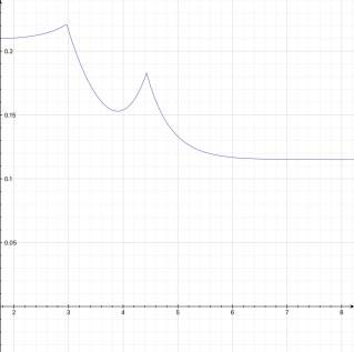

I have made a calculation for the case without added KCl.
The way I did it, maybe not the only one, is to forget about pH. I just calculate as a function of the added HCl, which in this case is the same thing as total [Cl-].
Remember I already said in #7 that it would have been more rational to present the data as function of this. And you will see in my figure a simple or simplifying feature that is not noticed, or mystified, in the presentation as function of pH.
So try and work out equations for that case as functions of [Cl-].
The curve below that represents molarity of maximum total B ([ B]+[BH+]) in solution is the lowest of the curves at every [Cl-].
This is a bit giving away the answer to your question of why the curve is of that peculiar form with kinks.
I might have hidden it from you like the book author does by giving only this lower curve and rubbing out the rest.
I hope this is sufficient enablement for you to do some calculations. That said, I cannot believe that the authors of what seems to be a standard textbook do not explain how to do these calculations, if not in the sections on either side of the extract then in earlier pages.

Horizontal [Cl-]. Vertical solubility

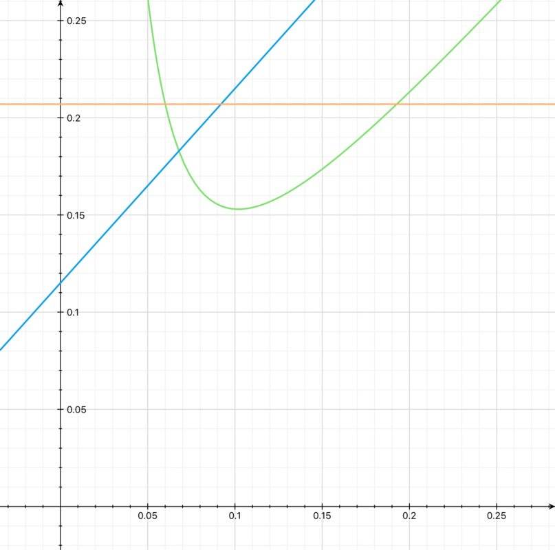

Hi, I was trying to think on the chart like you suggested. I made a small change in the drawing. In practice one could evaluate the total solubility (which we read on the ordinate axis) as a function of the pH (reported on the abscissa axis) as reported on the book or we could diagram the total solubility as a function of the concentration of [Cl-] on the axis of the highest abscissas as suggested by you. We know that at pH = pKa = 4.2 the [ B ] = [BH +] = [Cl-] = 0.08 while at pH = 1.7 the [BH +] = [Cl-] = 0.21. At pH = 3 St = 0.22. Should I calculate the [Cl-] graphically by intersection with the solubility curve of the base?[/B]

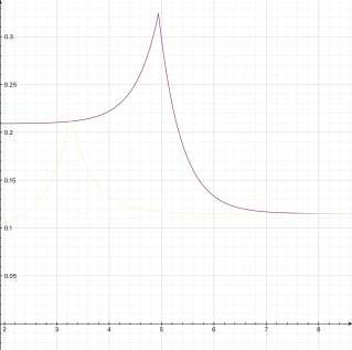

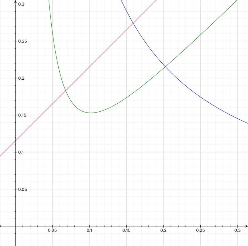

The three curves represent three different inequalities. Solubility, i.e. the total molarity of dissolved B in all forms (only two!), let us call it Btot, must be on or below all of the curves. Yes, they are mathematical functions generated from a model according to my understanding of the stated problem. If your solution was at a point on one of the lowest curves and you increased the amount of B, somehow keeping everything else constant then something would precipitate- but it would be a different substance in each of the three zones.
I now think that one of the curves was mistaken, and that it should be as in the new diagram below. Co-ordinates as before
I recognise that you have worked on this, I am only trying to lead you a place where your work could produce conclusions faster. For this we need to use the homework template, as thousands of students who have been helped here do all the time. I noticed now this template has changed slightly but its first section is Statement of the Problem, which we already have in detail with your #1. The second, and vital, section is 'state your equations' (understand broadly, to include inequalities and chemical formulae equilibria. known quantities etc). This is what the scientist trying to solve a problem like this would be doing anyway. In homework it can reveal misunderstandings, incompletenesses or oversights, and is like an agreed basis and terminology for proceeding further.
[H+] is extremely far from equalling [Cl-]. The vast majority of protons added with the HCl go to protonating the base.
It occurs to me that you would make faster progress possibly if you first considered a simple model in which the 2:1 salt does not exist. One would expect this to be treated in a textbook, and it looks like this is what the unknown equation 5 is about, I just don't know how much they confuse issues by talking about pH. In fact I think we need to see the relevant page/s now. (When copying pages preferably use an app like HDDocScan that cleans them up.)

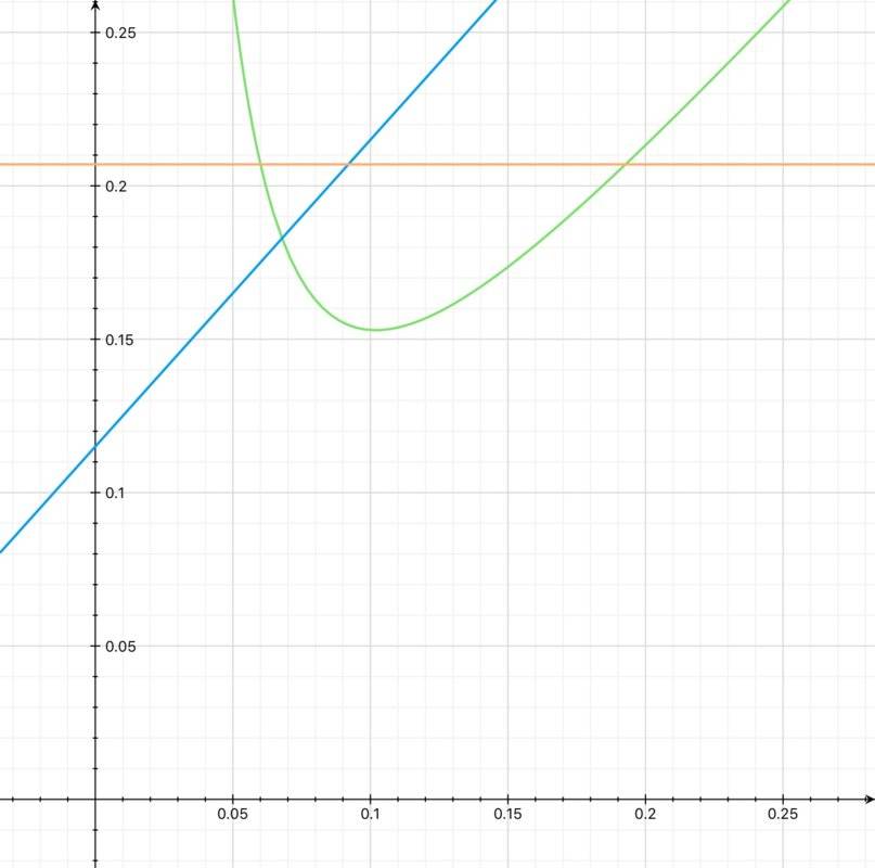

Here is the graph of solubility vs. pHI calculated from the constants given in your book. It looks convincingly like the book curve. I am sorry this has taken so long.
As you see in my two previous pics I couldn't make up my mind what was happening in the acid region. In fact there is a conceptual misunderstanding in what I said. Beyond the critical point or kink one cannot treat [Cl-] like an independent controllable variable. What you can vary is the added HCl. From the critical point onwards on adding HCl, [Cl-] is fixed and constant, nailed by the solubility constant and electroneutrality. [HB+] is Constant while [ B] declines with added acid as it is protonated and precipitates as a salt.

Hi Epiguin, I didn't make any big progress. On the book it says that "for pH values <4.5 the solubility of the 3tc does not increase linearly with a slope equal to -1 as would be expected if the base body was constituted by the free base" ... To me it seems however that solubility decreases linearly with a +1 slope but is only a supposition. I'll explain m = (y2-y1)/(x2-x1). At pH = 4.5 m = (0.165-0.162) / (4.5-4.2) = 0.3 / 0.3 = 1. Where 0.165 is St at pH = 4.5 and 0.162 is St at pH = 4.2 (in fact for pH = pKa = 4.2 St = [ B ] + [BH +] = s ^ 2 = [(Kps2; 1) ^ 1/3] ^ 2 = [(5.3 * 10 ^ -4) ^ 1/3] ^ 2 = (0.081) ^ 2 = 0.162. I hypothesized that if added HCl 0.01 M (not I know how much the HCl added, mine is only a hypothesis), 0.01 mol of B react and I know how to consume so that B decreases from time to time by 0.01 considering that there is no longer a background body that restores the intrinsic solubility - let me explain, if the base body were the free base the solubility should increase and instead decrease, so B must decrease and not remain constant, I have hypothesized that at pH 4.4 the [ B ] = 0.11-0.01 = 0, 10; At pH 4.3 the [ B ] = 0.10-0.01 = 0.09; At pH 4.2 the [ B ] = 0.09-0.01 = 0.08.If the slope was +1 then A pH = 4.4 we have that (x-0.162 ) / (4.4-4.2) = 1; x-0.162 = 0.2 -> x = 0.164; A pH = 4.3 is had (x-0.162) / (4.3-4.2 ) = 1 -> x-0.162 = 0.1 -> x = 0.163; At pH 4.2 ST = 0.162, ST- [ B ] = [BH +] for example 0.164-0.10 = 0.064 (in fact [BH +] = [ B ] * [H +] / Ka = 0.10 * 10 ^ -0.2 = 0.063) ; 0.163-0.09 = 0.073 ([BH +] = 0.09 * 10 ^ -0.1 = 0.071); At pH = 0.162 the [ B ] = [BH +] = 0.081 ... Clearly I do not know if it is right but what happens for 3 <pH <4.2? If the 2: 1 salt starts to melt you say that [BH +] remains constant while [ B ] decreases, but since it is converted to 2BH + by adding HCl + BH it should not be the other way around? That is, should it not remain constant B at 0.08 and grow BH +? Can you explain this to me better? Furthermore for Cl <4.2 it remains constant also Cl-? By critical point do you mean the minimum point? The [Cl-] remains 0.08 from pH = 4.5 onwards because if I add more HCl the surplus of Cl- precipitates in form of BHB + Cl- salt? I had hypothesized that at pH = 4.5 the [Cl-] was about equal to [BH +] or 0.05 and that by addition of HCl 0.01 M at pH 4.4 [Cl -] = 0.06 at pH 4.3 [Cl -] = 0.07 and at pH = 4.2 [Cl-] = 0.08 ... Is it wrong then? Perhaps Cl- remains constant for pH <4.2?Thanks in advance.[/B][/B][/B][/B][/B][/B][/B][/B]

I have calculated this curve (horizontal axis pH, vertical axis solubility) from the constants given by these authors.

In brief, as for your various considerations which are hard to follow, if you have made some calculations they should be set out clearly as section 3 ("attempt at a solution") according to the homework template I linked to earlier, for just those reasons set out in the link. Please stop talking about "bottom body" etc. and find the right English words.
For some clarifications you ask: by "critical point" I mean a kink where the solubility curve changes slope.In both cases, the simple case of simple salt treated in the book, and the more complicated case with the 2:1 complex, I am saying that at pH above the high pH kink, [ B] is constant, below the low pH kink [ BH+] (and Cl-) is constant.
"On the book it says that "for pH values <4.5 the solubility of the 3tc does not increase linearly with a slope equal to -1 as would be expected if the base body was constituted by the free base" ... To me it se.ems however that solubility decreases linearly with a +1 slope but is only a supposition". Increasing linearly with -1 slope and a decreasing linearly with +1 is the same thing. However the book is not right in saying that this is with pH, it is with [H+].
As for thinking about the 2:1 complex we solubilities and tendencies, this is quite difficult at first, so I didn't; I just calculated. One should try and make intuition and calculation coincide and reinforce each other. But sometimes one comes first and sometimes the other. In fact I found some qualitative insights that the calculation led me to only last night extremely interesting. This solubility curve has a minimum. And the calculation shows that this at this minimum [ B] = 2[Cl-]. When you think of it this is obvious, or at least plausible-sounding. The composition of the precipitate is B2HCl. So you could think that the solubility of a salt like this is minimum when the solution composition is exactly in the proportions of the precipitate, that solution contents to one side or the other of the proportion do not contribute to precipitation. I had not been aware of such a principle before now.Not completely sure of it yet, or how far it extends, I have a little problem with the H. But it seems we may have a principle for rationalising precipitates like this; is there anything in your book about it? Is any forum reader more familiar?
And still more. The above tells you that at this minimum [ B]/[BH+] = 2. Which gives us that
pHSmin = pKa - log 2
Which gives pHSmin = 3.89. Look at the curve, we seem to have very good agreement between theoretical production and experimental results! A very interesting system after all I'm finding.

What you are doing wrong is resisting writing out just what the whole problem as in the homework template section 1, which could be done in about the same space and time as the above. Followed by sections 2 and 3. I do not know what is stopping you doing this. It would save me time and effort if I just did this for you, but it would be fairly unprecedented on this forum that the homework helper wrote the question in place of the student. I am only persisting because this problem is an interesting extension of ones we already frequently treat here, in which interesting things, challenges and even principles seem to emerge.
For what it is worth I calculate the pH at the high pH critical point to be 4.42. I am taking B0 to be 0.115 from the graph in the publication. Above that pH things are exactly as in the theory and equations of your book for the simple case, so any strange result is no doubt due to some banal mistake in the calculation. Below that point [ B] is no longer equal to B0.
