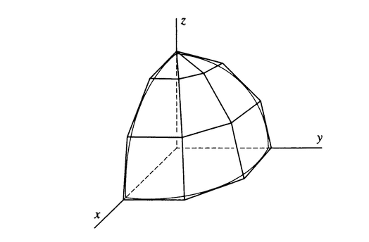

doubt in the derivation of the expression for calculating the surface integral for a function F.
this method of derivation is approximating the function using a polyhedron.

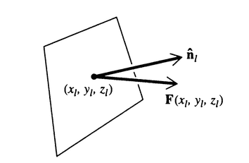

concentrating on one of the surfaces(say the L'th surface which has an area ##\Delta S_l## and let ##(x_l,y_l,z_l)## be the coordinate of the point at which the face is tangent to the surface and let ##\hat n## be the unit normal vector)
the area of this surface is given by ##F(x_l, y_l, z_l).\hat n_l \Delta S_l##

my doubt in this derivation is why is there a dot product being taken between the vectors and then multiplied by the area(basically I don't understand why this equation, ##F(x_l, y_l, z_l).\hat n_l \Delta S_l## give the area as shouldn't the summation of all the ##\Delta S_l## simply be equal to the surface area of the function??)

No - the area of that little piece is just ##\Delta S_l##, whilst the (so-called) vector area of that little piece is ##\hat{n} \Delta S_l ##. The term ##\vec{F} \cdot \hat{n} \Delta S_l## is the "flux" of the vector field through that little piece, and by extension$$\Phi = \int_{\Sigma} \vec{F} \cdot \hat{n} dS$$is the flux out of the surface ##\Sigma##. For example, consider some fluid with velocity field ##\vec{v}(\vec{r})##. The volume of fluid that passes through the little piece of area ##dS## per time ##dt## is ##\vec{v} \cdot \hat{n} dS = (v\cos{\theta}) dS##. Note that this is the volume of an oblique prism of base area ##dS##, slant length ##v## and height ##v\cos{\theta}## between the faces at either end, which contains the fluid that has flown through the element per ##dt##.

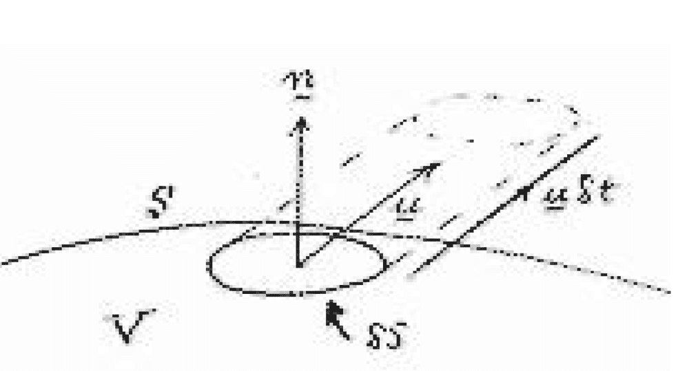

Nothing's really been derived here, I think that's sort of the definition of the flux of a vector field through a surface. But I tried to give some motivation by looking at volumetric flow rates, maybe have a look at this figure:
You'll notice that the volume inside that oblique cylinder is ##\vec{u} \delta t \cdot \hat{n} \delta S##, from which you might deduce the volumetric flow rate through a surface is ##\dot{V} = \int_{\Sigma} \vec{u} \cdot \hat{n} dS##.
