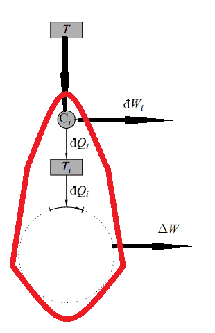

I have attached two images from my textbook one of which is a diagram and the other a paragraph with which I am having problems. The last sentence mentions that due to violation of 2nd law we cannot convert all the heat to work in this thermodynamic cycle. However what is preventing the carnot cycles from doing work dW_i ? Shouldn't ΔW be the only work that is impossible to achieve by the machine? Why take ∑dW_i + ΔW <=0 and not just ΔW<=0?
I would also like to know that since at the end of one cycle reservoir the system returns to it's initial state and T loses some heat and if total work performed by that system is zero(for reversible case) then where does the heat go?

No. The system undergoing a thermodynamic cycle is the Carnot cycle plus the other cycle. This is the system that appears to take heat from one reservoir and get work out without rejecting heat to another reservoir. Since for any thermodynamic cycle that is connected to only one reservoir the cyclical work must be less than or equal to zero, it must be so with this cycle too. The cyclical work involved for this cycle is the sum of the individual works outputs from anywhere in the system.

But the carnot engine which produces dW_i work is connected to 2 reservoirs. How would this work be negative or zero?
It is not the Carnot engine that is considered in the equation you are asking about. It is the combined system, shown in red in the image below. For this system, would you agree that ##\Delta W+\Sigma dW_i \leq 0##? That is all that they are saying. Once you see this, you should be able to see that ##\Delta W \leq -\Sigma dW_i##.
