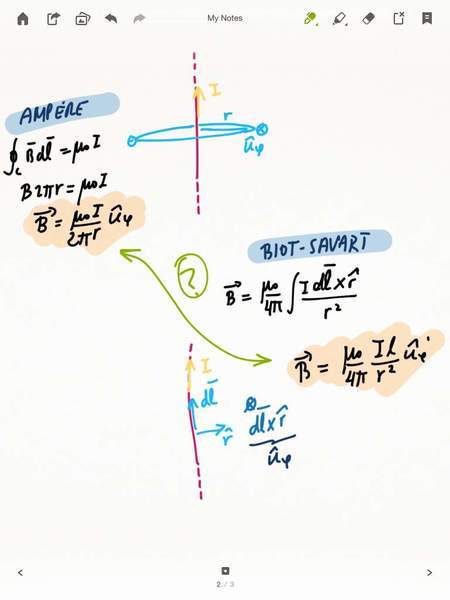

Hello,
I think I'm terribly wrong by supossing Ampère-Maxwell and Biot-Savart are referred to the same concept of magnetic field B. For example, for calculating B near an infinite line, I used both, as I understood them, obtaining different expressions (see image). What is that that I don't get?
Thanks
You didn't do the Biot-Savart integral right. Let the wire go up the z-axis, and the integral is
[tex]B(\rho) = \int_{-\infty}^\infty \frac{\mu_0}{4\pi} \frac{I e_z \; dz' \times (\rho e_\rho - z' e_z)}{(\rho^2 + {z'}^2)^{3/2}}[/tex]
You treated the denominator like it doesn't depend on [itex]z'[/itex], but it does. I write it [itex]z'[/itex] to emphasize that it is the integration variable (not the position we want to find the magnetic field at). Consult a table of integrals to easily find the antiderivative.
In general, for some current density [itex]j[/itex], the Biot-Savart Law is
[tex]B(r) = \int_{V'} \mu_0 j(r') \; dV' \times \frac{r - r'}{4 \pi |r - r'|^3}[/tex]
Actual line currents (not densities) just reduce this integral from a volume to a line. Compare with the electric field from some charge density:
[tex]E(r) = \int_{V'} \frac{\rho(r')}{\epsilon_0} \; dV' \frac{r - r'}{4 \pi |r - r'|^3}[/tex]
for vectors [itex]r, r'[/itex]. You can see these are both really the "same" law. The function [itex](r-r')/4\pi|r-r'|^3[/itex] has special significance in 3D space. Wiki "Green's functions" if you're interested in learning about it.
Thank you very much, that was really helpful, I appreciate it!
Carlos
