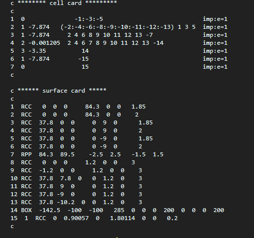

Geomtry 15 is strange
15 1 rcc ? I think it is the problem

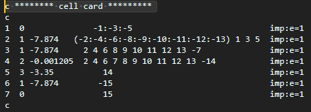

The geometry 15 is a rigth circular cilinder at the middle of the canon rotated 135 degrees. I found in the MCNP manual (page 4-15) that´s the way to rotate the geometry, maybe i use it in a wrong way. Here's my code:
Fuente Cañon_Completo
c
c ******** Tarjeta de Cel *********
c
1 1 -7.874 -15 imp:e=1
2 0 (-1:-3:-5) 15 imp:e=1
3 1 -7.874 (-2:-4:-6:-8:-9:-10:-11:-12:-13) 1 3 5 imp:e=1
4 1 -7.874 2 4 6 8 9 10 11 12 13 -7 imp:e=1
5 2 -0.001205 2 4 6 7 8 9 10 11 12 13 -14 imp:e=1
6 3 -3.35 14 imp:e=1

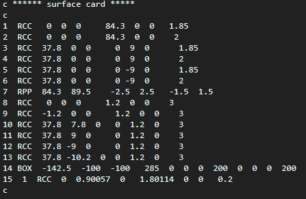

c
c ****** Tarjeta de Superficie *****
c
1 RCC 0 0 0 84.3 0 0 1.85
2 RCC 0 0 0 84.3 0 0 2
3 RCC 37.8 0 0 0 9 0 1.85
4 RCC 37.8 0 0 0 9 0 2
5 RCC 37.8 0 0 0 -9 0 1.85
6 RCC 37.8 0 0 0 -9 0 2
7 RPP 84.3 89.3 -2.5 2.5 -1.5 1.5
8 RCC 0 0 0 1.2 0 0 3
9 RCC -1.2 0 0 1.2 0 0 3
10 RCC 37.8 7.8 0 0 1.2 0 3
11 RCC 37.8 9 0 0 1.2 0 3
12 RCC 37.8 -9 0 0 1.2 0 3
13 RCC 37.8 -10.2 0 0 1.2 0 3
14 BOX -142.5 -100 -100 285 0 0 0 200 0 0 0 200
15 1 RCC 0 0.90057 0 1.80114 0 0 0.2

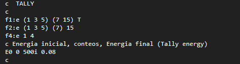

c TALLY
c
f1:e (1 3 5) (7 15) T
f2:e (1 3 5) (7) 15
f4:e 1 4
c Energia inicial, conteos, Energia final (Tally energy)
E0 0 500i 0.08
