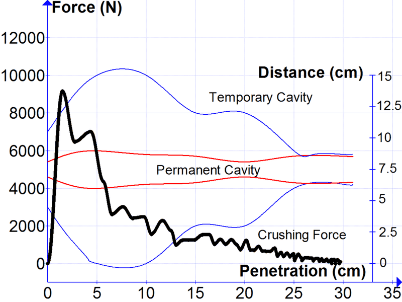

Predicting bullet penetration from first principles is an extremely challenging problem, and is not yet solved in the general case. People who really want to know the answer for a given projectile and target have no recourse at the present time than to perform experiments.
Some simplified cases are beginning to be understood: nondeforming bullet in a homogeneous isotropic medium like water or calibrated ballistic gelatin.
One challenge continues to be that material properties are not known at the high strain rates of ballistic impact.
Likes jim mcnamara
http://www.investigativesciencesjournal.org/article/view/17572/11372
The link shows a recent publication illustrating our experimental approach of using high speed video to quantify the interaction forces between a bullet and ballistic gelatin. The attached figure from the paper suggests the difficulty of predicting these force curves from first principles. The ripples in the force curve for distances beyond 5 cm may be attributable to experimental noise, but the second peak near 4.5 cm is real (it is repeatable). Most simple computational approaches predict a single peak, and there are none that we know of that can accurately reproduce the peak interaction force, the depth at which it occurs, or provide quantitative agreement with the tail.
Theorizing with drag equations is easy. Obtaining quantitative agreement between theoretical predictions and measured force curves is hard, even though the area under the curve is simply the initial kinetic energy of the projectile.

I like this illustrated reply , what I wonder is why couldn't they(experts in general) use the drag formula to account for various densities of tissue/material(target). They could have also use laws of refraction to calculate the bullet changing course slightly as it transitions from say the liver to the heart (change in densities).And then they can compare the theorized results to the experimental.

Going through a fluid, the drag coefficient is not constant, but varies with velocity. Going through a visco-elastic medium (tissue or ballistic gelatin), there is the added complexity that the medium is being damaged to allow the bullet to pass, so quantifying the energy needed to rupture the tissue is also challenging, as it depends on velocity and bullet shape and diameter. Finally, in many cases, an additional complicating factor is the deformation of the bullet. Even in a homogeneous medium, it is a very complicated problem.

Hi thanks for this insightful reply. You say the Drag Coefficient changes according to speed of the relative fluid. Is there a formula to predict this or is this all experimental testing only?
Regarding tearing the tissue, I believe I mentioned a solution to this not too while back in this thread about using the tensile strength of the tissue? So if you know the force of impact on the new medium you can calculate the pressure and compare this pressure to the compressive strength of the material being impacted upon.
Here is a reference: https://en.wikipedia.org/wiki/Compressive_strength
If it fails to overcome this compressive strength then the bullet should deflect, if it does succeed then it should refract.
Regarding the bullet deforming and melting etc I have decided I don't need this level of accuracy for now in my simulator. That just the big picture Newtonian mechanics and fluid dynamics should be suficient to give a reasonably accurate simulator.
